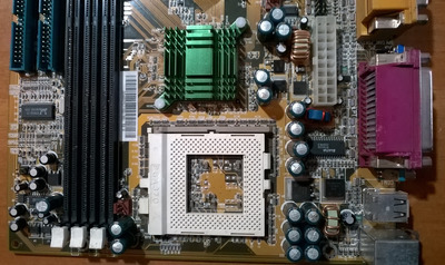

I've been repairing several motherboards, as long as they have swollen capacitors, it's quite easy for me to fix them, sometimes they need other work, trace repairs, lost smds, bios to rewrite, sometimes you just need to find the correct jumper settings, or the right RAM.
Currently I did some work on various motherboards, in a Gigabyte GA-7ZMMHC, I replaced all the 1200uF 6.3V electrolytic capacitors, I had a bit of difficulty with some holes, which I could not free, because the tin has hardened and I could not melt it.
It's a socket 462 (A), it currently runs on a Duron 1000MHz, for RAM I can only use PC100 or PC133 DIMMs, I believe it's an early generation 462 CPU card, it has integrated video, I'm pretty sure you use part of the RAM as video memory, there is also onboard audio, but no LAN, to add it you need a PCI card or find a CNR.
Previously I restarted a socket 7, SOYO SY-5BT, unfortunately it has a cache problem, one chip PIN (No.8 ) is missing, not having a spare chip, I have to try to do a job, like that which is done on the DALLAS chips, in practice you have to remove a little plastic (above), to weld a wire, which restores contact with the motherboard (of the missing PIN).
It's not an easy job, if you have any ideas or suggestions, I would greatly appreciate them.

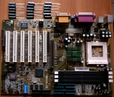

Today I worked on an ABIT SE6, I removed all the capacitors (from 1500uF 6.3V), in total there are 18, although visually OK they were all mostly in loss, one with ESR off scale (>40 Ohm), and a 'other open, I haven't soldered the new ones because I want to check the smaller ones (from 100uF 16V), there may be some to change, but I'll know after I test them, I hope they are ok, even if the brand (JACKCON) does not bode well, being the same as the ones I changed.
