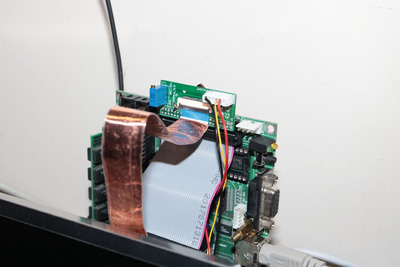

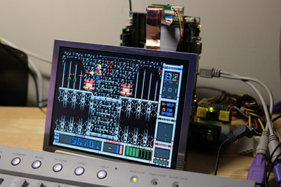

Finally got this LQ080V3DG01 behaving with the smaller SBC that I wanted to use it with, this one didn't go so easily. It was still giving noise on complex enough screen:
  • In line emi filter on clock line = good improvement, went from unusable to noise on some screens
  • Shorter cable = good improvement. This cable is too short but it gives 100% noise-free display
  • Bypass capacitor for LCD power = no change
  • Changing connector to top opening one = possibly some improvement though that may have been correcting a soldering error for the emi filter.
  • Adding copper guitar tape to the outside of the 20cm flex cable, with tape around that for insulation = good improvement, clear & stable on windows shutdown screen at last
Very happy with this now, since the LCD is being driven directly by the graphics chip I think there should be less latency than if it was going through a VGA LCD display. A little LCD with a tiny PC104 SBC is my kind of 486.
Once I tidy up the design a bit I can share the PCB design for this adapter board, you'll notice it has a lot of bodges, but since I only had to worry about 5 of them it's easier to re-work what I've got.
Not sure if I mentioned the others when you posted before, only extra one I've got deets for here is Coby DP1052 photoframe that has a LG/Philips LB104 S02 panel in which details seem a little scant for but appears to be RGB 6:6:6 ... another one I picked up was a bust and had LVDS panel... but, just discovered a Johnstown Atom board I have might be able to drive it, so might get bodged to that for an XP system.
I have a few bus buffer chips, I'll have to look up if they are fast enough to clean up signals some. Without getting too analog and into the RF magick, I think it would be desirable to do low pass filters where the entire signal bandwidth is below it, and the glitches above it hopefully get blocked. I dunno if I'm making too much sense at the moment, having a bad brain day.
I think I got lucky getting 640 x 480 ones, it's worth checking up the specs or online manuals first. Mine all seem to have all either 32-pin flat cable, and Sharp or Toshiba pinout 31-pin hirose connectors. In my opinion there's not that much to worry about with RF for TTL LCD panels; it's only the clock signal that's running at a higher frequency over 20mhz. Everything else is pretty much in the hz or khz range so signal integrity of the digital data isn't much of a problem.
It gets easier with LVDS too, that has built-in noise filtering for all the clock and data signals on just 4 wire pairs. You just need to make sure each wire pair is twisted together and it should work without issue. I've even seen bodges of LVDS cables without the proper twists working quite happily at 1024x768.

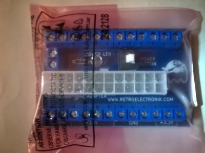

Is that just a generic ATX breakout board? That looks great. I've gotta try something similar with a DigiPOS computer that has a crazy external PSU.
No, a French seller on eBay was making them two or three years ago. There's a website address silkscreened on them but it fails to load now. I hadn't seen them listed again so they may not be selling them anymore.

I feel like I've seen similar at Universal Solder, Tindie, or Temu or somewhere like that.

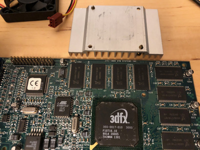

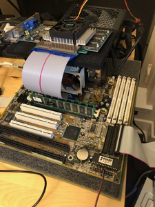

Took the heat sink off my Voodoo 3 to better figure out the best way to get a fan on it, and replace whatever heat sink compound was on there and, well:
1.68 MiB
1612 views
Yes, it was bone dry under there. I felt a little ill. Again, I'm new to Voodoo 3s, is this a common thing I should have known?

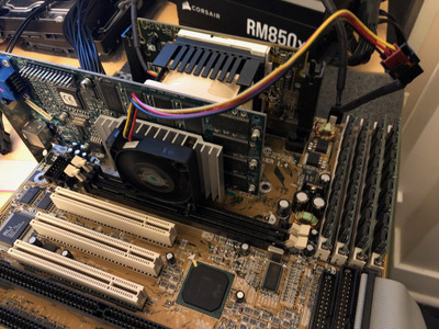

Anyway, glad I'm getting it sorted now. Got the ram clearance licked too: 😂

If the heatsink had never been removed before then it'll still have the thermal epoxy glue they used, so yes it would appear to be bone dry which would be perfectly normal for epoxy. But now you have it off you can throw some superior TIM on it with a nice fan and itll run far cooler than it ever did stock.
nVidia and ATI also used the evil Thermal Epoxy .. Geforce 4 cards were a pain in the arse to replace the cooling on because of it.

you just twist before you pull the radiator , so you don't pull the chip with the Thermal Epoxy.

Never had any success with that method, freezing the cooler with an air blaster does work though as it makes the epoxy brittle and itll generally come away in full with the cooler.
Id rather not twist old coolers in any case, the BGA chips don't like stress like that and it can damage the BGA solder balls.

Ah, good to know. If they're not generally available then I'll probably just solder stuff onto one of those ATX 20 > 24pin cables and use a similar picopsu. Your upgrade is very tidy and professional looking even if there's a lot of wiring 😀

Good solution, going to EDO might have a bit of a performance hit though??? Probably worth testing which is faster.
Thanks for sharing the pictures too, I don't know that I've ever removed the heatsink on my V3 3000 so I hope that one at least has epoxy rather than no thermal interface at all.

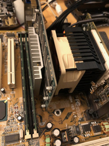

Well, I can say for certain that mine showed no evidence of any sort of thermal coupling agent whatsoever. Just the ugly marks of aluminum abrading on ceramic. The heat sink could be wobbled by hand on the mounting springs before removal, so def no adhesive.
Thermalwrong wrote on 2023-06-11, 19:49:
Good point, going with this now:

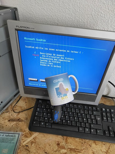

I definetely didn't get up to do that. But using my W95 HDD on an IDE->USB reader corruped the system files.
Now getting it fixed the lazy way.

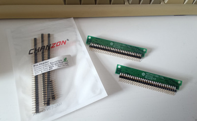

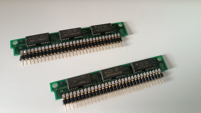

Convert SIMM RAM to SIPP.
What better way to relax, than doing small welds 😀

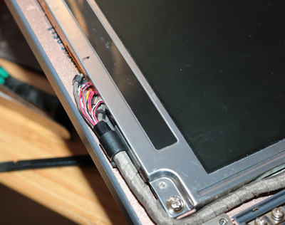

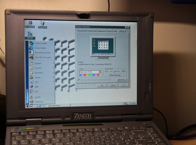

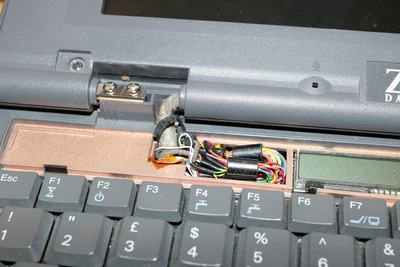

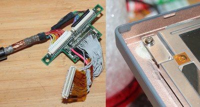

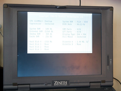

Today I had to do two completely unwanted repairs on my Zenith Z-Note GT 120mhz Pentium - which I was putting back together, giv […]
Today I had to do two completely unwanted repairs on my Zenith Z-Note GT 120mhz Pentium - which I was putting back together, giving its screen back (borrowed for tests) only to find that it wouldn't turn on. It was behaving like there was a short.
I tested between a component labelled BCxx near a component and both sides connected to ground, oh no. There was a dead short on the 5v power to ground. Had to take it all apart which is tough considering I was never able to find a service manual for this thing, here's how it looks in one piece - not mine but very similar: https://wiki.preterhuman.net/Zenith_Z-Note_GT
After probing around for about half an hour, I looked more closely at this metal shield that blocks the PCMCIA slot from the inner case, it screws and solders onto ground points but at the corner it's going over a trace that connects to a fuse... I desoldered that shield and the short was gone. What a relief, I don't want to do component level troubleshooting on this old thing. Resoldered that back into place with some Kapton tape underneath to give some insulation.
It now powers up though I'm not running it until the casing is back together since the crazy design means the top case is half of the heatsink and there's no fan. The way it's designed is pretty bad in my opinion, the heatpipe has to be carefully guided through a narrow hole and from my last work on it, the aluminium shield/heatsink got separated from the plastic top case. I broke all the plastic weld points - having these as two parts makes it even tougher to put back together, so I've fixed all of the plastic pegs with superglue and baking soda. The edge of the keyboard area on the top case is a thin part and that was broken in half, so I used some 2.54mm header pins and melted those into the ABS plastic after supergluing.
Beware if doing that, the fumes from superglue melted are quite bad for you, I had a fan running to avoid those.

When back in one piece, it's a pretty nice albeit quirky laptop. Similar in spec to the Toshiba Tecra 500CDT, or the Satellite 430CDT but with L2 cache. Mine has a smashed screen but one day I'll resolve that too.

It's been a while since I've posted about my Zenith Z-note GT laptop, which had a broken screen. It's been sitting around the flat and on my desk as a pile of parts.
When received a while back, it came with a smashed LCD - it's an NEC 11.3" (NL8060BC29-01) and that's really hard to get replacements for. Another dead laptop that I disposed of had a Sharp LQ11S31 11.3" 800x600 TFT and I thought it would be a simple process to get the Sharp working in place of the NEC panel.

It wasn't that easy though - my adapter made from the LCD board that connected to the NEC LCD, which was wired up using those thin copper wires from an 80-pin IDE cable, wasn't good enough. I spent ages making this Sharp LCD some new standoffs in the screen housing and all it would display was a rolling noisy picture on the LCD. I thought it was a video BIOS problem and this laptop has sat on the backburner.
In the last couple of weeks I've learned about the importance of signal quality for high frequencies (40mhz) from other LCDs I've been messing about with on industrial PCs. And how to improve it without getting into the physics stuff, with ferrite cores and shielding.
I found a nicely made cable that had the same LCD connector in my parts bin(s), a 41-pin Hirose which had lots of shielding tape and little ferrite cores covering a few pairs. I re-wired this "ASKA rev.0" cable that may have possibly come from a Toshiba 1620CDS, to fit the 41-pin Sharp pinout. The wire colours were picked so that red/yellow was colour data and white/black were grounds, which made figuring out which wire is what much easier.
The Clock and DE signals each go in their own shielded wire pair with ferrite beads.
642.79 KiB
1220 views
The connector on this cable I'd use instead was totally different from the connector used by this Zenith Z-Note GT laptop, which is a generic Taiwanese made laptop with a Chips C&T CT65548 graphics chip. There are three connector headers:
LCM - 15 pins - This I think means 'LCD Mono' with the minimum viable number of pins to run a monochrome LCD. That would be odd on a Pentium
LCD1 - 14 pins - These are I think the extra pins for DSTN and TFT screens,
LCD2 - 8 pins - Extra signals for TFT screens, adds 6 colour signals. Toshiba do the same thing
To figure out what the signals were on the three connectors, I worked back from the known pinout of the original NEC LCD panel.
39 wires and lots of heatshrink. It barely all fits into the space that the original cable took but it's working and the covers fit back into place.
1.14 MiB
1220 views
It's not 100%, I didn't place the screen quite level with the new standoffs I had to make for the LCD. And it does seem there is a minor difference in the LCD panels, because the display although working correctly is shifted down by ~3 pixels. I might fix that in future through potentially modifying the video BIOS, but for now it's working and the LCD is actually pretty fresh and bright.
238.11 KiB
1220 views
The laptop itself is nothing all that special hardware wise, a fairly generic Pentium with ES1868 audio and Chips VGA. The Z-note GT is a Zenith rebrand of a Taiwanese laptop chassis which I've seen other brand names on.
But I need to fix things when I receive broken stuff, so I'm happy at this point, and I learned some lessons about signal quality along the way - the mess of wires in this thing helps me to understand why the industry pivoted to LVDS all at the same time.
