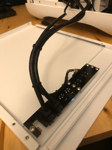

I finally busted a wire on the cable a certain case uses to connect the front panel headers. This case has its "front panel" stuff on a side panel, actually, which is rather annoying and the cable was too short to lay the panel down flat with it attached - the only other option was to detach it and this type of connector is not designed for regular attaching and detaching.
29.28 KiB
1646 views
I teased the crimp out, trimmed and replaced the wire, and put the crimp back in the plug - and immediately broke it again because that wire is now shorter than all the others. I looked up the plug type (JST PH 2.0 8-pin), looked into getting the stuff to redo the whole plug, but then I had a much stupider idea. I had this HD Audio cable from another case and noticed it used the same plug and hmm, it's 2x5 pins so maybe...
45.15 KiB
1646 views
Works like a charm. Strapped it to the side panel USB cable for some strain relief and I'm thinking it's not so stupid after all:
596.85 KiB
1646 views
Yup, feelin pretty clever right now.

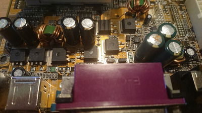

Im in a slightly similar spot with a Gigabyte GA-8I875 P4 Titan board I got in the mail today, at least 6 caps need to be replac […]
PD2JK wrote on 2023-06-26, 19:42:
Inspecting this MS-6168 board, it does post but the caps... Same old story so time to replace them all.
Im in a slightly similar spot with a Gigabyte GA-8I875 P4 Titan board I got in the mail today, at least 6 caps need to be replaced due to bloating but what I didnt notice till it arrived was that some animal has somehow torn the ATX connector off the board leaving the posts there. (The seller did take a pretty clear picture of the ATX connector missing ...doh)
https://www.gigabyte.com/Motherboard/GA-8I875-rev-21#ov
Il have to replace that too, thankfully a closer inspection didnt reveal anything else missing or needing to be replaced, the caps are not super bloated so I will just replace the ATX connector and see if the old girl is still alive before going further.
Other than that its a nice looking board with a P4 HT 550 3.4Ghz in it.

All the capacitors died, leaked or exploded while in use. In the end I replaced them all and no more surprises.
I was startled many time with popping caps 😀 it's always a show! 🤣

With that in mind .. I shall recap it before powering it on 🤣 or .. ill turn it into a parts board and get another identical to it, not sure which will be cheaper since getting the right caps can be a game in itself.

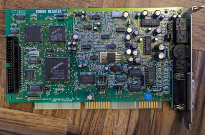

I accidentally added to my XPS collection today, in addition to the 450, the M2010, and the 8700, I now have a 720 (with a GT 730 in it, which is actually a downgrade from stock). It was practically foisted on me at the recycler (that had previously been very strict about not "swapping" stuff) when I took in some parts. I may make a post for the mini-haul when I take some pictures, unusual number of ISA cards as well, untested (mostly IO cards). It's weird, I was literally trying to clear some darned space! I 've been so tired I'm a week late going to the scrapyard, and I'm still trying to catalog stuff for people to buy/take and not making much progress. Kind of wiped out, but the guy at the yard helped move the printer, which was pretty heavy.
I pulled a horrible decaying battery off a 386 mobo (which weirdly had a soldered *and* plugged-in BIOS battery). I probably won't be testing any of it for a while, except maybe the XPS (missing some parts but still heavy as heck!).
But there was this:
212.85 KiB
1500 views

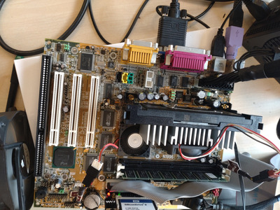

Fresh caps. Doing a test run, Noctua noise killers added. Working as planned.
    1.87 MiB
    1272 views
    MS-6168 board

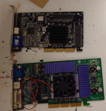

I finally upgraded my main retro rig (Pentium III 1GHz, Win98SE) from a GeForce 2 MX to a GeForce 3. I've had this card for over a year now but just hadn't got around to installing it (and to be honest, for what I play on that machine the old card was fine). To my surprise it's a Ti500, though only the 64MB version, I thought it was an early plain GeForce3 (it had very few markings to identify it by). It was given to me by a friend who pulled it from a random computer destined for recycling. I think the fan is not original but it seems to work fine. I played a bit of Quake III and I'll try to give it more of a workout in the future.
310.37 KiB
1905 views
269.15 KiB
1905 views
I thought about swapping the USB card for a USB/Firewire combo card while I was at it, but I don't want to risk running into driver issues or resource conflicts and I don't really need Firewire on this machine, so I left it.

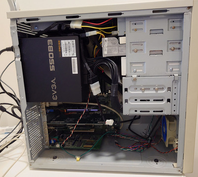

Recapped my Athlon DOS monster. It's a Chaintech 7AJA2 KT133A mobo with an Athlon XP 2600+ CPU, probably as fast as it goes if you want ISA without resorting to obscure industrial mobos for later platforms. Didn't look too good, luckily noticed it before any disaster:
The attachment imagex0001.jpg is no longer available
Back in business. Still some cable management to do:
186.92 KiB
1891 views
