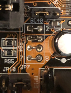

Today I took out a cute little Zida 5DVX I picked up recently and was verifying the jumper settings for the P166 MMX it came with - all good until I got to the voltage jumpers and was confronted with this:
243.75 KiB
1830 views
Those are all supposed to be open for 2.8v. Uhg. I could snip them sure, but that's not something that's easily reversible for me (for now; I'm working on upping my game in that respect - yes, I can see that some pin headers could be installed there). I would rather put a non-MMX Pentium in there than make the mobo MMX-only, unfortunately I don't have any non-MMX CPUs. 😅
For now I'll stick with this similar Gigabyte board but I'd rather have the Intel chipset on the Zida board...

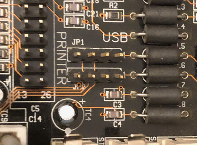

Edit:
Also, these are the USB headers:
574.37 KiB
1826 views
C'mon fellas... 😂

If I was being lazy, I might just apply a soldering iron to the bottoms of those wired jumpers and push them flush to the board on the back, so there was about an extra 3mm in the loop on top.... then snip them carefully in the middle, and unbend them straight up with a pair of needlenose pliers and tadaaa, row of what are practically jumpers, caps will sit on them for trying stuff out, not as durable as the tinned bronze pins of course.
Reply 24584 of 27685, by appiah4
They could be soldered in place because your particular revision lacks a regulator for split voltage altogether..

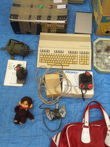

Vintage market 2023 July.
Fairly big with street performers and some noteworthy vintage electronics.
997.33 KiB
1736 views
926.94 KiB
1736 views
I didn't spend that much though. There was a seller with a lot of banana boxes and a lot of hardware in questionable condition, but each item was only about 1.5€ so I thought I take my chances.

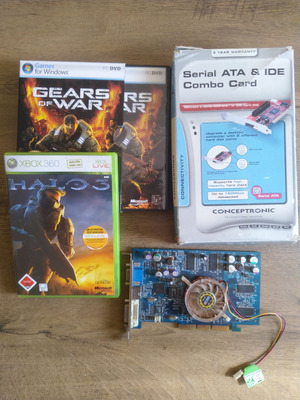

The result:
Abit Siluro Ti4200
SATA&IDE controller
**I also picked up a kensington lock and a mini hand drill
1015.13 KiB
1736 views
From different sellers a slipcover Gears of War for PC and a Halo 3 for Xbox. It was only at home that I realized Halo was the German version, but it either defaults to system language or the game itself is not localized.

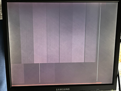

As for the Ti4200, at first it didn't post on DVI so I tried the VGA output and yeah... it seems to be faulty. It's a little prettier in Windows, with only 5 vertical lines of corruption, about 2cm thick, so maybe salvageable?

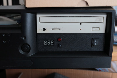

The other day I made this 3d print for the 486 DX4 100 VLB, AT motherboard I jammed into this MicroATX desktop case:
302.29 KiB
1693 views
I have a box of spare 5.25" blanks and one of them happened to fit so I modelled up its clone in Fusion 360 and put in some cutouts for the power switch and turbo button. I forgot the reset switch so it looks like this version is going to use the power button for reset instead.
Unlike the last time I made one of these things that adds a turbo display, this time I have time to make the display actually do something. I bought a bunch of 3 digit 7-segment displays a few years back for my 1st 3d printed case front, but it sat unused because back then I didn't know enough about electronics or arduino to make it work.

Maybe? I'd recommend recap, reflow, and reflash VGA bios. Those are usually the big 3, if none of those do anything its probably either a bad BGA that would need a real BGA rework, or a faulty memory chip. Inspect for missing components as always. Little SMD resistors having broken off is another common one.

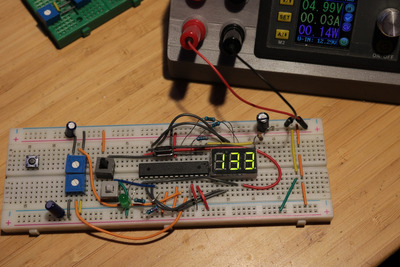

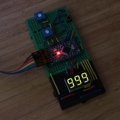

And it's behaving on the breadboard now with an Atmega8A, this is getting transferred to a stripboard PCB tomorrow. Kinda funny, the bugs I had to track down were each caused by my trying to make the variables more efficient (changing int values to bytes)
635.37 KiB
1641 views
Reply 24590 of 27685, by BitWrangler
Cool stuff, that's yet another project I've got on my multitude of back burners. Pondering something fancy that flips jumper settings for me. I've got an idea that with some clockchip plls, that they way they support deturbo, it may be useful to buffer speed switching such that things don't glitch. Also had a mind to blend function with an arduino drive emulator, that has a bunch of images, so it's all push button to boot into things at the right speed. IDK if that's going a bit too far though, removing all the retro touchie feelies. Anyway, it's a bit of a "this is the way I personally wanna do things for me" kinda thing, even though there are other similar things out there.

Agree'ed (I second that ... list of sugestions).

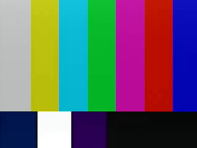

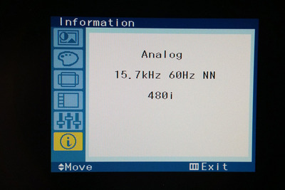

Attempt no.1 to go the "hard way" and convert the tube camera's RGB to something vga-like
The LM1981 worked great to take the sync signals from the composite out and make the horizontal and vertical syncs that a monitor happily locked to:
140.78 KiB
1473 views
But it doesn't like the RGB, which I piped right out of the camera (set to output rgb).
793.26 KiB
1473 views
And what the camera is outputting:
20.48 KiB
1473 views
It almost looks inverted. If anyone out there can give some advice, I'll take it.
And yes, the monitor is capable of working with a 480i signal, I also tried on an old ultrasharp with composite in and the same thing.

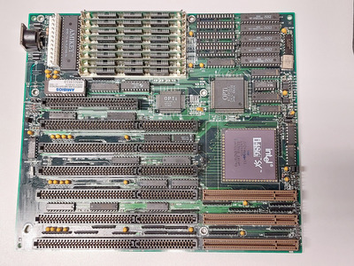

I've removed the battery, cleaned the damaged area and fixed traces on this 33 Mhz 486 VLB motherboard. According to the Retro web I believe this is an unknown 495XLC motherboard: https://theretroweb.com/motherboards/s/unknow … x-vlb-1x-8b-isa
The thing is, I cannot locate the turbo switch. Can anyone help me on this one?
Reply 24596 of 27685, by appiah4
It may just not have one. On some AMI boards you use CTRL+ALT+[+] CTRL+ALT+[-] to Turbo/Deturbo IIRC.

I've tried it and indeed it works. But honestly, I don't like this turbo/deturbo option via keyboard very much. However better than no turbo/deturbo at all.

Is it not the jumpered 2 pin header next to TB LED? I.e. with the jumper on the header turbo is always on. Difficult to see from the photo. What happens if you remove that jumper?
