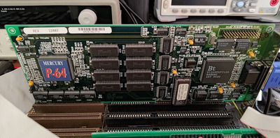

Playing around with recently acquired S3 VLB card.
This is beast for 1994. So far ahead of time that it's not even VESA compatible out of the box. Compared to 1MB GD5428 I own clearly step up.
I mean 100Hz refresh rates across the board. With 2MB VRAM 1024x768x64k is possible. I could only imagine how expensive CRT monitor it required to drive back in 1994.
Well it turned out to be by far my most expensive ebay purchase (so far). There is always someone who wants it as well...

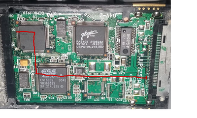

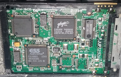

Reply 25512 of 27680, by creepingnet
BitWrangler wrote on 2022-10-15, 03:13:
I wonder if it's already going to the modem audio pin and is just muted with no modem activity.
Just revisited this one today involving my M/75 and the KXL-D20 card. IT looks like pin 62 (pin for audio out to internal speaker) goes to a NEC 62522 Gate Array chip. Not sure what modem audio it would be using, since there is none, but could be a mixback of some sort too - but that'd mean possibly risking the laptop, or finding the pinout of the Qlogic FAS408 SCSI Controller chip and tracing the lines from there back to the connector.
So I did some more prodding around with a VOM in there, found that pin 62 (the pin for Speaker out in PCMCIA) goes to the fifth pin down on the right side of the NEC 62522 Gate Array chip. Tried looking at some datasheets for that chip, could not make heads or tails of it.....but I think I might be able to bodge it in with some careful soldering though to that pin - and then test with the laptop.
    184.54 KiB
    1657 views
    Better shot of the card without the drawing on it
    1.03 MiB
    1657 views
    A quick sketch of connector points on my card

Thanks for sharing the pictures, I don't think I've seen the inside of one of those cards before.

Oh well, it's one of those days I knew it will come. I cant recall over past 6+ years hardware dying on me. Now it happened and of course it's my most expensive purchase. 🤣
No picture today while booting today. Quick voltage check on BIOS and ram chips suggest no issue with power. I could not find RAMDAC datasheet, but it gets warm so power is present. S3 main chip is however cold.
Need to do more digging. Should probably try to read eprom chip externally...
I have no experience troubleshooting video cards... ...I guess now I have good opportunity to put my small home lab equipment into use and try to learn something new...
Reply 25517 of 27680, by Kahenraz
vutt wrote on 2023-10-08, 10:28:
I spy lots of little yellow tantalum caps. I know that these are known to fail on old motherboards, often quite spectacularly. I'm not certain whether they fail silently though. I would check all of these for a dead short as the lowest hanging fruit for repair.
Reply 25518 of 27680, by BitWrangler
They go short circuit, so if there's enough current available, they self immolate, if there's not, they might just sit there getting kinda warm and stopping shit working, but not burn out.
