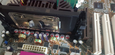

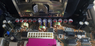

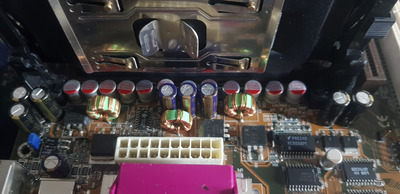

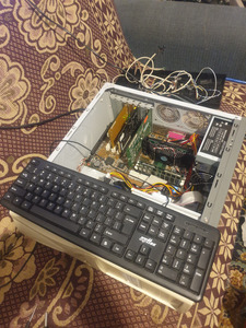

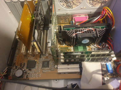

Speaking of ABIT... rebuilt this old one. BE6-II rev1 + P3 650.
I have 2 modified slotkets yet none are stable with Coppermine chips so I'll just stick to the normal slot variant.

Isn't it very close to the BH6 construction wise? I ran one of those with a 600 @ 900 Celeron on some generic slotket rock stable...

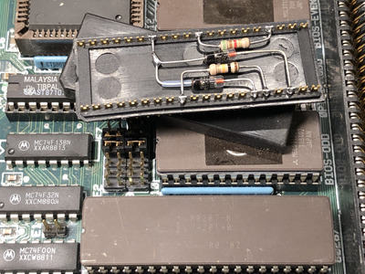

Today was a mixed bag of retro computing...
Thanks to vogons user @Balog i now have a second FastRAM Card and a 287 co-processor for my ast premium 286.

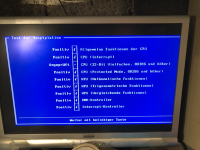

First good news:
The 287 co-processor works perfectly fine.
I removed the "jumper" co-processor and installed the new one. That was simple.

The FastRAM card itself works. It detects the 512k ram and works.

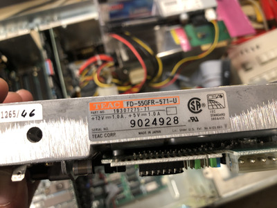

Now the really bad news.
I think i have killed the 5 1/4 floppy drive.
While i was tinkering with the computer i wanted to boot from a 3 1/2 floppy.
I connected the floppy drive to the system but i reversed the data cable.
I noticed the drive lights are both on and turned off the computer.
I turned around the data cable and started again.
From that moment i can not get the 5 1/4 drive to read disks.
The drive seeks normal on bootup, and when i want to read from it it starts to spin , drops the head and after 5-10 seconds i get a general reading error.
Does somebody have an idea what could be blown? here are some pictures of the drive.

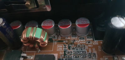

Have one of those boards. There is like 20+ caps around the slot, and most of them are junk.

Mine is "polymodded" for the most part. I kept a few Panasonic caps from my first recap on it though.

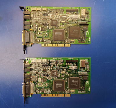

Spent a frustrating couple days trying to get sound cards to play nice in Windows 95.
I'm trying to build a 1997 period-correct setup and using a Diamond Monster MX100 as one of my sound cards. Unfortunately, after installing and testing the one I have, it has wavetable MIDI playback issues where it won't play back the left channel audio. It produces faint distorted audio instead. This only affects wavetable MIDI audio; digital audio is perfectly fine.
975.25 KiB
1376 views
In contrast, the MX200 sound card works perfectly fine. I suspect the issue might be the SMD capicitor that sits between the wavetable header output and the AD1843JS chip. Alternatively, it might be the AD1843JS chip itself. But I won't know without further testing.

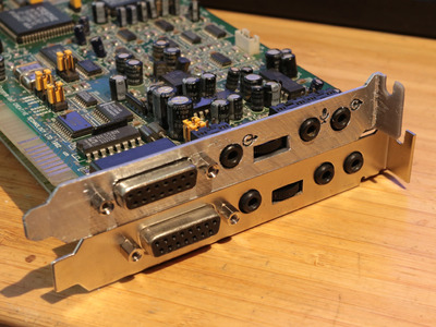

Then I tried to get a RAP-10 card installed and that also proved to be a disaster. While I could get the RAP-10 to work by itself, trying to install both a Diamond Monster Sound and RAP-10 resulted in a bunch of unresolvable hardware conflicts.
1.03 MiB
1376 views
Making things more challenging is the RAP-10's lack of a proper Windows 95 driver (it only has a Windows 3.1 driver). After repeated attempts to remove the drivers, I ended up with no audio working whatsoever.
At this point, I nuked the entire Windows 95 install and will be starting over. 😒
