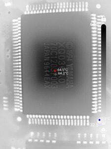

Wrangled with some ISA soundcards today. To be more specific, Yamaha SW20-PC, Reveal SoundFX SC400 Pro 16, Samsung Audio Magic X and an OEM HP Aztech 2320.
And somehow I revived 2 graphic cards, a no name S3 Trio 3D/2X AGP and a Matrox G200 PCI.
Nice, what did you do to get the video cards working again? I've had non-working cards work from just cleaning the PCI contacts or re-seating the BIOS.
I've been doing the same thing today on my slot 1 test bench setup - testing out the Yamaha DB50XG that I got inside of a computer I bought recently. I thought it had some fault because the main chip gets relatively hot going up to 60c?
105.01 KiB
908 views
It sounded very wrong playing passport.mid and canyon.mid but sounded fine in games. It seems to just be some mapping issue with those midi files since XG midis from FF7 play fine and games sound excellent with it.
Just to be safe, the Yamaha chip by the ROMs now has a flat ceramic 40mm heatsink on it since I've got a bunch of them for free and they do work.
*sigh* the card it fits best is the CT2950 soundblaster 16 but I heard the hanging note bug within just a few minutes of gameplay - time to modify the soundblaster's DSP with one from the Soundblaster DSP thread.

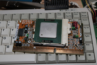

Then thought I'd finally test out my Tualatin mod on my MS6905 slotket - last time I used this slotket I thought I had completely broken it since neither tualatin or P3 worked so I read up and re-did it. Sadly I did that ~4 months ago and have no idea which mods I did. I plugged it into the board to test it and it works! 1.2GHz Tualatin celeron working on my Aopen AX6BC board.
1.17 MiB
908 views

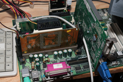

Oh it was toasty though for some reason after about 2 minutes of operation and it's got a junk bin HSF on it right now just for basic testing.
Why is it so toasty??? The CPU voltage on the slotket is set to auto, that should mean it will go at 1.5v like the CPU says right???
1.02 MiB
908 views
Uh... checked with multimeter and it's running at 2.08 volts...
This 1.2GHz Celeron may not work for very long now - the slotket has manual voltage settings and it's now running at about 1.53 volts being set for 1.5v operation. Oops!

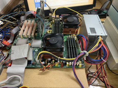

Today I installed copper heatsinks (9mm x 9mm) on the VRM mosfets on this P2B-B 440bx motherboard to help keep them cool. One of them gets quite hot at 2.0V, too hot to touch, so hope these will help. A case fan will blow over them.
I'm slowly overclocking the FSB, starting at 100MHz and am at 120MHz now. Trying to reach 133MHz while taking some CPU-Z and 3DMark99 measurements along the way.

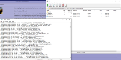

Uhg... digging through a parts box that I got last year and it was all in really rough shape so I put it on the back burner.
Lots of dead late-AGP cards.
One card that seems to at least power on is a Sapphire X1650XT AGP. Problem is, I can't find and stinking drivers for it. I have four different versions (9.12, 10.2, 14.4 and one other version) and none of them have support for the X series??? They have support for everything all the way back to the Radeon 9000, up to the HD4000 and HD5000 series, but no X800, X1600 etc.... what the heck is wrong with ATI drivers? Why are two generations of cards randomly missing from all of these driver packages? Why did they make this so hard? I could, presumably, drop in a Radeon 9000 Pro, 9700 Pro, HD2600XT or an HD5670 and they'd all work. Even using the manual install method to load an .inf, there is just nothing listed for the entire X series in any of these packages. 😠
How did this user use all of these versions for these cards?

I just got the 10.2 package from AMD's website and it does list X1650 Series in the XP inf, CX_95952. It's the same driver I used on my Sapphire X1650 Pro until its death alongside a HIS X1950 Pro, both AGP.

PcBytes wrote on 2024-04-12, 21:53:
Thank you. When I Googled ati 10.2 xp I got this Guru3D link:
https://www.guru3d.com/download/ati-cat ... -(32-bit)/
I have gotten drivers from there for years and I didn't see any reason to believe it was modified, however, the downloaded file is only 46MB compared to 77MB for the one straight from AMD's site. Checking the .inf I see that this particular package is missing everything prior to the HD2000 series. The file on guru3D was uploaded 14 years ago. 😕
*sigh*
Was someone really going around and modifying drivers to remove things? Why are the X series also missing from all of the other packages I have which should support them? 😕
I will try installing the 10.2 set from AMD.
Is it possible that AMD actually modified the "Legacy" packages to include as many cards as possible, where as the old downloads from 10-15 years ago lacked certain devices originally without modifying the inf? So confusing...
EDIT: Yep, 10.2 "Legacy" direct from AMD works fine. I still don't understand why the X series was removed from all of the other packages I have though. I'm checking all the .inf files manually, and they either only go back to the HD2000 series or they only cover the 9000 series. This must be why Windows was saying I only had drivers for those, with the X series missing entirely. This is what I get for going to threads about how to find the "best" ATI drivers, ending up with some "best package" from a third party site, and it turns out it only supports like a third of the cards the driver package is supposed to support.
EDIT2: Woohoo, the card just blue screened during 3Dmark 2001SE. Awesome! 🙄

i'm dusting the old 940 opteron board, trying to max the ram and install the os to feel the power of all that ram stick 😁.
i got the feeling that my board all having some quirk somewhere.
the H8DCi will run the memtest just fine but will absolutely won't boot windows and boot linux sometime in a while or kernel oops when it like to oops.
the DK8N will recognized the ps/2 keyboard but after bios post, the keyboard will froze, at least usb keyboard works without having to change the bios setting. also usb controller is not working under linux for this one while the usb port of the H8DCi work fine under linux.
1.62 MiB
512 views
board
also it seems like my 750w psu (antec eag pro 750w) is having problem, after running DK8N with that PSU, the board will absolutely won't post (no post code at all and post card display four dash) and that gave me a fright,
changing the PSU to the other one in the picture revive the board so at least no permanent damage had been done yet.
