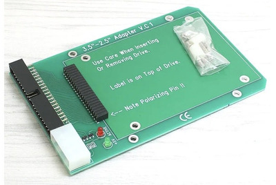

Has anyone had much luck with this style of flat PCB based 2.5" to 3.5" adapter?

I've got mSATA drives in most of my retro machines using the JMicron based 2.5" IDE adapters - either the ones with a caddy or the smaller bare PCB ones. But the common adapters for connecting 2.5" and 3.5" IDE always seem kind of janky - especially the black ones with the Molex power leads just soldered to two of the pins. So when I saw this type on AliExpress I thought it was a great solution as it gives you a firm mounting for the 2.5" drive, and the IDE header faces out rather than up, which is helpful in tight locations.
I only just got around to testing it with an mSATA adapter and got really weird results - on a retro machine the drive is detected by the BIOS as usual, but it won't boot and FDISK (from a boot floppy) won't even see it and quits with an error. I tried it on a USB adapter on a modern machine and it seemed to be either randomly not detected at all, or detected as a removable drive with no media. The power LED comes on, but nothing at all on the red activity LED.
If I plug the mSATA to 2.5" adapter directly to the USB adapter, or to the retro PC via a janky adapter, it works fine! So the problem is in the 2.5" to 3.5" PCB. Which seems weird! Isn't it just passive? Even weirder - when I tried with an old 2.5" spinning disk, that DID work OK via the 2.5" to 3.5" PCB.
I tried reflowing the solder on the 40-pin header as some joints didn't look good, but it made no difference. Might the little black SMD components near the power line be doing something odd? As far as I can see they're the only difference between this and a purely passive adapter?
(also worth saying, I assumed the outer holes on the PCB would match up with the standard 3.5" HDD bottom mounting hole locations - but they don't! )

Try using it with a cable select punched IDE cable.

Tried the adapter with two different cable select type 80 wire cables (the original one was 80 wire but only one drive connector) but still no luck with the mSATA adapters booting or being accessible (but still being recognised by BIOS OK). Again the adapter worked fine with a different spinning 44pin drive though.
I've never known any other drive or adapter fail to work with the USB3.0 adapters either ... Seems really weird!

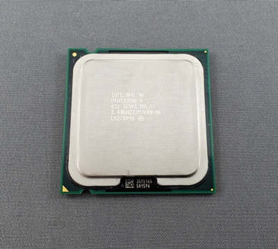

Been testing throttling and benchmarking of this Cedar Mill Pentium 4 651 (SL9KE).
Turns out it can nicely approximate a 486 DX-33 with both L1 & L2 cache disabled. Adding in additional throttling options pushes it into 386 and even 286 territory.
