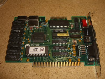

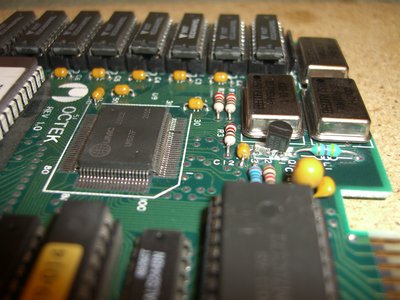

I installed a VGA card in my XT clone so it's ready when my new XT-IDE card gets here next week, or that was at least the plan.
I bought an expensive (not really but UK shipping chough chough) 8bit ISA VGA card for this system two weeks ago. It was sold as tested by a UK seller that sells volume and only gets good feedback so I diddn't even test the card as the XT clone was stored away. Now when I tested the card my XT clone did not even power on with this card installed, as in not even the PC-XT PSU wanted to start. The system works totally fine with a Trident 8900C so my suspicion directly fell on the new 8bit ISA VGA.
I tried the card in a 386 board with with a normal AT PSU, the exact same thing happend. This made me take a closer look at the card looking for freight damage as my £10 shipping strangely enough diddn't cover a box. The card came with only some ESD protection in an envelope but as the card diddn't look beat up I diddn't really think much of it other than the seller beeing unnecessarily cheap.
I found this transistor, its hard to see but the middle leg was perhaps shorting with the outer leg. There is a piece of plastic there which probably is meant to hinder these legs from shorting but it was already disloged in the sellers picture so when the transistor got beat up during shipping perhaps it created a short serious enough to short out any system the card gets installed in? It's either the transistor or the two welded togheter pads on the UM587F chip also visible on the picture, it would be strange if it was the welded togheter pads though as they are also visible on the sellers picture. I can however not find anything else looking messed up enough to hinder an AT PSU from powering on.
4.26 MiB
2499 views
I have not lookied into the dip-switches much as there is no documentation on the card online. I have found the documentation for the chip so I know what 3 out of the 4 dip-switches are supposed to do just not which is which other than a fair guess but I seriously doubt the fourth DIP-switch is to short out the card. 😜
No other casualties than the card it self lucky enough. I have made sure the transistor isn't shorted any more (if it ever was) but the issue remains the same, perhaps the card is totally shorted out, perhaps the seller only dreamt he tested the card 😜
All in all two thumbs up! Very nice!!! The seller gives 30 days warrenty on his items but I have not decided if it's worth the trouble for £25 including shipping. It is a rare card, I have not seen another one like it.
4.41 MiB
2497 views
If anyone can think of any other reason for a card hindering a PSU that is powered on with a f*****g live mains switch from powering on other than beeing one big short please let me know. 😀

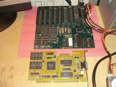

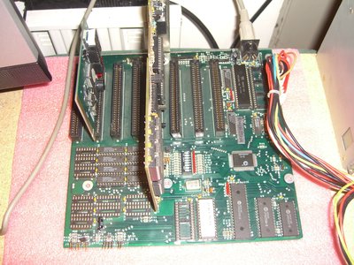

I have now tested my "new" sold as "untested" Juko "Nest" Baby XT board with another set of 8 known to be working 44256 memory chips from a 286 board, it still won't post.
This is how I have setup and jumpered the board. The memory chips can only go in the 8 sockets they are placed in as they are the only DIP-20 sockets. The Trident 8900C video card is working in my XT-clone computer so it works even with a 8088 CPU, this is a V20.
The dip switches are setup using this linked Juko baby XT motherboard as a template. The dip switches seem to be set for 4 floppy drives but that is how the board came and should not hinder the board from posting without any floppy controller?
https://th99.bl4ckb0x.de/m/A-B/32279.htm
In case my boards dip switches do not fully match the ones on the linked board I have tried to set dip switch 1 on SW1 (parity) to both on and off. I have also tested to change switch 2 (NPU present or not) switch 3 + 4 (memory size) and 5 + 6 (monitor type). The reason I have not messed with switch 7 + 8 for number of floppy drives is that there isnt an option for 0 drives, only 1, 2, 3 or 4.
The diagnostic post card could very well be useless as I think XT boards sends post codes on address 60H and not 80H but I have both a monitor and a keyboard connected, not a PC speaker though as I'm not 100% sure wich header it goes on (I would guess J5). The 3.5" HDD is only to put some load on the PSU.
Edit
I tested the diagnostic post card in a working XT-clone system and it shows "FF" but nothing else, still "FF" is better than "--" 🤣
/Edit
4.35 MiB
2383 views
4.37 MiB
2383 views

I gave up on the Juko Nest XT clone motherboard with V20 CPU for now.
Instead I'm testing what kind of 16bit ISA video cards my working XT-clone with 8088 CPU likes.
I already knew that my Trident 8900C card workes (It's either auto sensing or was already set to 8bit), and now I have found that my Trident 9000C cards do not work even when jumpered for 8bit BIOS but there are many more jumpers I have no clue what they are supposed to do so it could be a "PEBCAK" error. The next video card I tried was a Realtek RTG3106 card and it worked at once without messing with jumpers!
I will try some more cards later. 😀
A tantalum cap may have shorted. Did you check the solder side for shorting pins? You can also remove many chips to exclude from being the culprit. Myself I would force some current from a regulated power supply in there and check which part gets hot.

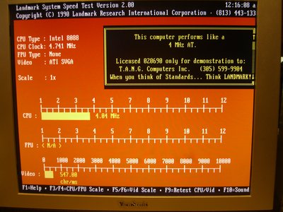

Dealing with the combination of dodgy 1.44M floppy drives, dodgy 1.44M floppies and 720K disk images are totally super fun!
If I write a disk image to an 1.44M ---> 720K floppy (tape ftw) with Winimage and then modify the disk in any way in my Windows 98SE computer it renders the disk unreadable. 😀
If I format a disk as 720K in Winimage and let it write an image to the disk Windows 98 reads the disk as 1.0M (not 720K). If I format the disk as 720K with DOS 7 Winimage needs to format the disk again before writing a 720K image as the disk isn't the correct format.
As long as I let Winimage do the full format and writing of imaged disks and let Dos 7 handle the formating (/T:80 /N:9) of disks I will use for non imaged stuff everything works though. The XT-clone reads both floppies written from images with Winimage and floppies formated in DOS 7 correctly as 720K with a random 1.44M floppy drive. My first x86 computer was an IBM 55SX PS/2 386SX-16 with a 1.44M floppy drive so I have not really messed much with older disk formats before, except for Atari disks and making holes in 720K floppies to transform them to 1.44M . 😈
Here are some awesome performance numbers.
The performance at 4.77 MHz.
3.89 MiB
2266 views
Just by the push of a button the performance reaches lightspeed. (it's 10MHz)
3.89 MiB
2266 views
