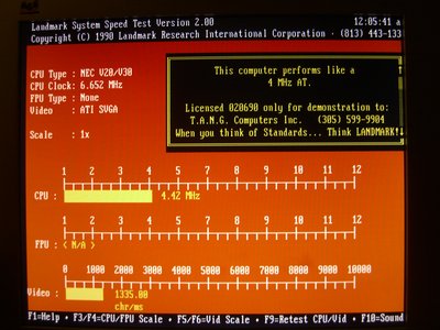

The V20 CPU from the Juko Nest baby XT motherboard did at least work! 😀
Removing a 8088 CPU when half of it is placed under the PSU with little clearance and then mounting a V20 without as much as disconnecting a single cable requires some gynecological skills. 😁
The CPU performance gain in Landmark is only 10% but the video performance gain is 30%! 😀
Note that the turbo mode video result with the V20 can't be compared with the turbo mode result with the 8088 I posted on the last page of this thread as I did not rerun the video test in turbo mode with the 8088. I fully expect the V20 would be the same 30% faster when it comes to video performance in turbo mode as it is in non turbo mode though.
Non turbo.

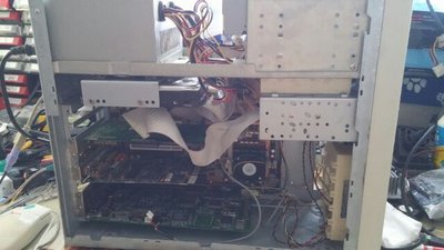

So after yesterday's failed 233 P2 I wanted to do something that works so ended up grabbing some of my old parts and a case I was going to bin , and built a P1 166mhz rig for Dos and windows 95.
About 2 years ago I found a old AT P1-133mhz at the bottom of a freezer soaked in water , I purchased it for parts (SB16 , Ram, CPU) and was going to bin the board but decided to give it a second lease of life , so I soaked it in PCB cleaner and contact cleaner , and left it to dry (till I forgot about it and dug it out today) 2 years should be enough time to dry a Motherboard...
Anyhow hats off to gigabyte this thing just works, and wants to keep on working no matter what 🤣
