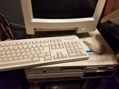

Reply 5202 of 27594, by bjwil1991

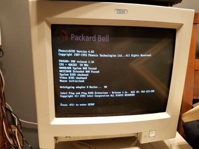

***NOTE:*** Don't comment about the mess in the background.

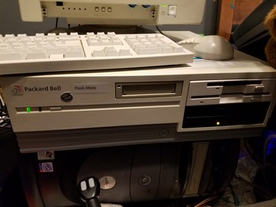

I have scored a Packard Bell Pack-Mate 28 Plus, as well as the keyboard and mouse for $17USD a couple of weeks ago, and I did some upgrades, installations, and repairs along the way:
Memory was upgraded to SIMM-72 (disabled internal RAM), but the memory isn't working right and I have the other memory handy since it was previously installed by the original owner
48x CD-ROM Drive is installed
FDD upgraded from 3.5" to dual FDD
Tape drive is in place of the original FDD
External CMOS battery is installed (repair)
Aztech Sound Galaxy NX Pro is installed
Music Quest MPU401 clone card is installed

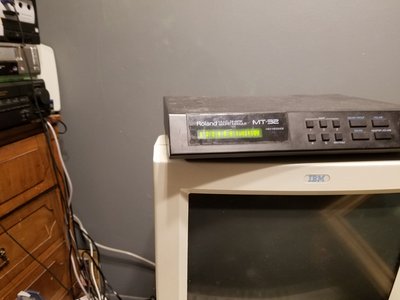

Roland MT-32 is hooked up to the MPU401 card
Gravis Analog Pro is installed
HDD was wiped and formatted, then installed MS-DOS 6 and upgraded to 6.22
iLive 2.1 Channel speakers with Bluetooth
IBM ThinkPad is used for making soundtracks from games using the Roland MT-32
Used my NEC MultiSync LCD1530V temporarily, but I'm now using my IBM 2115 CRT Monitor with the cable that was used in the NEC Monitor due to newer cables being shittier with less shielding, causing my CRT screen to turn pink, but no issues any longer.
Specs
Intel i486SX2-50
Packard Bell PB450M+ motherboard
Cirrus Logic VLB Integrated SVGA (upgradeable to 2MB vRAM)
Epson SD-800 Dual FDD
Mitsumi 48x CD-ROM Drive
Seagate 428.1MB HDD (was 210MB)
3Com EtherLink III ISA 10BaseT ethernet (installed by previous owner)
16MB SIMM-72 RAM (planning to use the other memory that was installed in the system)
Conner Tape Drive (max capacity 350MB compressed)

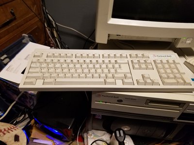

Packard Bell Keyboard and mouse
Gravis Analog Pro
Aztech Sound Galaxy NX Pro (SB Pro, Speech Thing, and Sound Source capable with a genuine Yamaha YMF262M OPL3 Chipset
Music Quest MPU401 clone card (made by keropi)
Roland MT-32
Memorex Telex 1201 Dot Matrix Printer (needs ribbon and paper)
Lo-tech Tandy Compatible Sound Card
I have some pictures down below

    Roland MT-32

    Mouse and Keyboard

    Keyboard

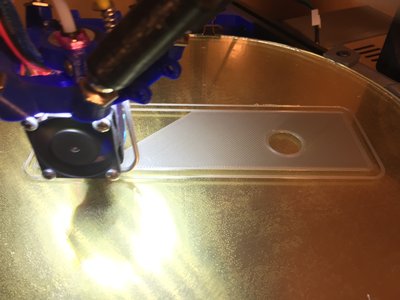

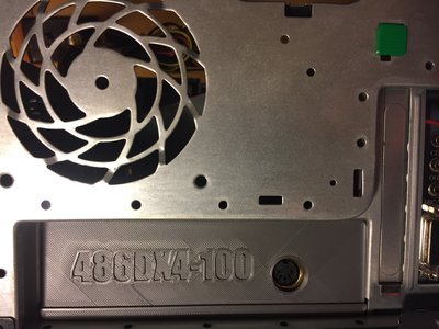

I designed and 3D-printed a custom filler plate for using an AT motherboard in a nice HP proprietary ATX style tower case I had laying around.
It's printed in a metallic colored plastic and actually worked out really nice!

While that does look totally awesome.. I thought part of back plates being metallic was to give ground connection to the keyboard plug/connector.. or am I wrong on that?

Electrically, the KB socket is sufficiently grounded through the motherboard. I'm sure having a proper steel filler panel would help cut down on any potential RFI, unfortunately AT ATX filler plates have become rarer than hen's teeth. So in my mind it's at least better than the big gaping hole most people would be forced leave there... 😀

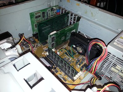

Today i came across some neat little system at local electronic scrap yard,hard bargain with the seller and got it for 7.5$.
I found it interesting formfactor after i saw whats inside.
So for the start it was dirty as ass,had no ram no hdd and dead cmos battery ofc,seller said it has dead psu.
On case was marks:
"did not see hdd"
"burnt"
"decommissioned"
Inside,on psu was a bold cross and the words "burnt"
Seems someone really did not liked it and wanted get rid of it asap 🤣
Inside was:
Tualeron 1100,Asus TUSC mobo,hfs,psu,floppy and asus cd drive
Aye googling says this system calls "ASUS Terminator Tualatin"
Anyway i cleared all shits away in and out,threw in pair sticks of sdram,upgraded cpu up to 1400 Tualeron,put in 80gb hdd,an audigy with front panel and installed *temporary* XP Sp3
Reply 5209 of 27594, by Kamerat
Got an Asus barebone with the TUSC myself, nice little system with the SiS 630ET chipset. The onboard SiS 7018 sound "card" are actually MS DOS compatible, I even modified the initializer so the Wavetable part can be used in pure DOS. The OPL3 emulation of the "card" are hilarious BTW. 😜

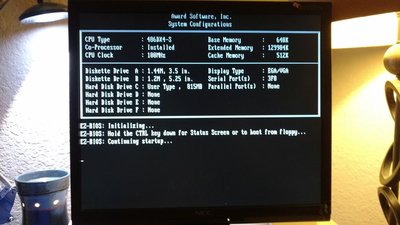

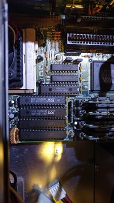

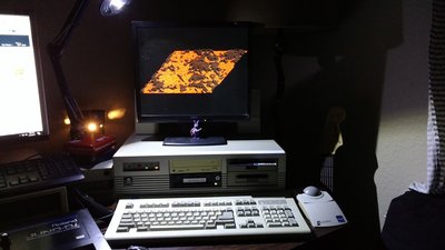

486 is finally finished as of yesterday, got the 128kx8 chips in, 512K on first boot, probably the smoothest part of these final upgrades to this thing. Which means next I can focus on the PURGE more. Just trying to decide weather someone would prefer the Gateway 2000 as a stock "of the period" socket 7 system or if they'd prefer it hopped up with all the PCI insanity including a SoundBlaster Live 5.1 value with the LiveDrive 5.25" bay module + all the other fancy stuff. But I'll deal with that more when I'm done with some other stuff. Also have the same decisions to make about the Dell Dimension 4600 P4 system, esp since I have all the original documents and other crap that came with it.
Next 2 things I'm doing to my vintage machines are VERY simple - V20 and 8087 in the Tandy, which I'm doing this summer, and the 286 is getting it's 2MB RAMpAT card back - whenever I feel like pulling it out and doing that (probably also in the summer).
The 486 with the 512K Cache seems even more faster and stable, ran Quake, comfy now, and I got QuartzAudiomaster Freeware to work with it - which requires a Pentium 90 or better (HEHEHEHEHE) - will do some more test recordings with it and see how well a VLB 486 with adjusted buffer settings can handle it, though control response is not immediate, might try some other Win9x recording apps as well and see how they do - or tinker a bit with a lightweight DAW for Linux - just for giggles. I'm mainly doing this just so I can honestly claim I recorded _____ on a 486 DX4 🤣
Installing the cache chips was pretty simple once I got past bending the pre-bends a little more so they fit the sockets, just something to note about installing brand new DIPs on an older motherboard, and only had to change one jumper.

    Post Surgery, playing some Afterdark Screensaver magic

    Confirmation on boot

    L2 Cache Chips installed

Love Packard Bell's dude! Good to see someone else giving one a little love. 😁
I have like 12 (got one more and another monitor after I took this photo) now I think and hopefully that number will keep going up. 🤣
