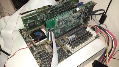

Currently in the process of gathering, testing and making things work together. In order to build a Dx2-66 VLB system.
As of now, I currently have it running with:
- Abit AH4T VLB Motherboard.
- Intel 486dx2-66 Write Back.
- 24mb Ram. (probably downgrade to 8mb)
- S3-805-1mb VLB. (Spea-something??)
- Goldstar VLB Controller. (single channel IDE)
- Creative SB16 CT-2890. (Vibra16 with an OPL chip)
- Floppy.
- 32mb CF Card.
- CD-Rom reader.
I am waiting for a dual channel VLB controller and I am waiting for a 512mb CF card.
The reason for getting that dual channel IDE controller, is that my last CD reader will not work
alongside my CF card adaptor. Hence the reader being attached to the soundcard right now.
Then I will have to see, if I am able to obtain/source some AT cases.
Uhhh.... Allmost forgot to mention that this is running with an ATX PSU and an ATX-to-AT cable.
I have had MS-Dos 5 running on it, and switched it to 6.22. Then I played Lotus, Dyna, Wolf3d and
finally played a couple of levels of Doom. I have totally forgot that I need a Dx2-80 in order to
make the most demanding parts of Doom run 100% fluid. Dx2-66 can do, I just need to upgrade
this machine to a Dx2-80 later on. Depends what games run too fast and too slow with a Dx2-66.

Anyway...
I was so blown back to 1990/93. A real awesomme trip back in time. Loved it. 😜

Does that motherboard have a 40Mhz fsb setting?
If so, you can always see if that DX2-66 is stable at 80 by just bumping up the bus speed.
And if something is a bit too fast, and the board has the 25Mhz fsb setting, you can bump it down to 50Mhz.

With that kind of cooling on your CPU I would just bump the FSB to 40MHz with your current CPU in place, 66MHz often ran only with a heat sink while 50MHz 486's had none cooling at all. I would worry more about running two VLB cards at 40MHz than overclocking a 486 by 21%. 😉
Edit: looks like cyclone3d got that before me. 😉

According to the manual, it should be able to run that and up to 5x86-133. And in my box of CPU's, I have an Amd 486dx2-80. For this system, I think my dx4-120 is a bit overkill as well as the 5x86-133.
