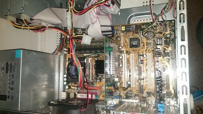

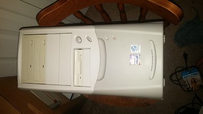

Finally got my PIII system a home and put it together. Next thing is to get 1GB of ram and an SB Live! Platinum with Live Drive, as well as an ASUS iPanel. I may eventually get a different MB, but I don't see much reason too. Still can't figure out what GPU to put in it. Maybe a VooDoo 3 and keep my my Dell XPS systems purely nvidia.
ASUS CUV4X-C
PIII 1GHz
384MB
FX5200 256MB
SB Live! Value

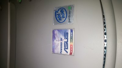

So awesome the case came with the right badges too!

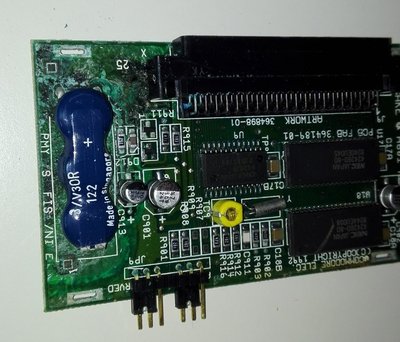

First of all,sorry for my poor english as usual 😀
Well, yesterday night i was quickly browsing through the forum, and i stumbled upon a post regarding the a600 memory expansion / rtc . The one with the badly damaged board due to a leaked battery.
Well i've completely forgotten that my a600 has a memory expansion, and i've never checked it because it's enclosure, the rf shielding,it's tightly soldered.Uh-Oh
Today's work: Memory expansion check! And , well , THE HORROR
141.61 KiB
1229 views
1/3 of the board looks like a Van Gogh painting

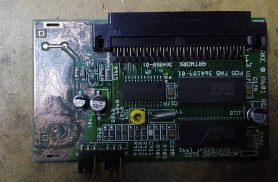

With a little bit of panic , i decided to desolder the battery, scrub the nasty stuff and check the connections.
Used a brush,fine sanding paper, and a pointy dremel tip for the hard to reach parts
260.89 KiB
1229 views
This is after 30 minutes of treatment. Luckily all tracks emerged from the crystals unscathed
I did not use vinegar or citric acid to neutralize that alkaline stuff(well i guess its basic), but i'll check it again to see if the corrosion is spreading or has stopped.

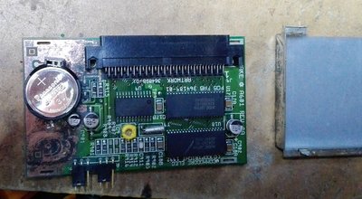

Added your regular 3v battery with battery holder and closed the rf shielding.
187.56 KiB
1229 views

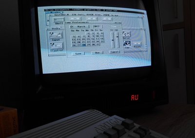

Well time to check it! And...
169.29 KiB
1229 views
Well it works! 1.7M memory free,also the clock seems to work
Whew. close call, but i strongly recommend to check / remove batteries from your unused devices all the time

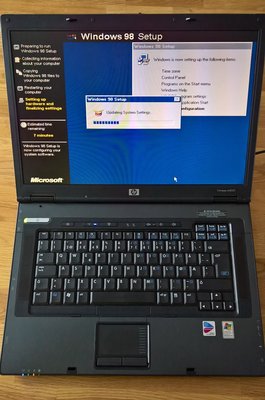

Maybe beating a dead horse to try Windows 98 SE running on a HP nx8220 with a 915PM chipset, but have not given up yet. Just some drivers missing, but its only the ATI Mobility Radeon x600 (PCI-E) i care for. Having problems finding a driver for that and the Broadcom NetExtreme 5750a1m NIC. Tried a lot of drivers, but the device id isnt in the inf files.
HPs W2K softpacks for audio, bluetooth and the ich6 chipset were installed sucsessfully. Not sure about if bluetooth works correctly, but no yellow in device manager.
