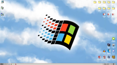

Reply 6922 of 19629, by cj_reha
Retro-fied my computer as much as Windows 10's crippled personalization features would allow me to. 😜
    1.26 MiB
    890 views

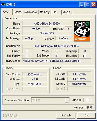

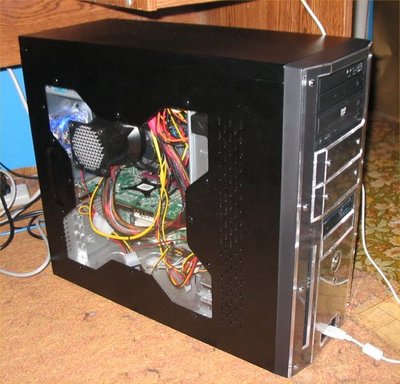

I finally updated the BIOS on my EPoX 9NDA3J Nforce 3 Ultra Socket 939 board to the latest version after scouring the internet and discovering it at a Hungarian download site.
I bought the board back in 2005 and used it with an Athlon 64 3000+ 1.8Ghz. With the latest BIOS, however, it supports dual core CPUs up to the FX-60! So, I took my brother's old 4200+ from his dead Abit AN8-32x (that I just can't seem to fix... the solder on the caps doesn't want to melt, even with my Hakko iron set to 850F... even after pre-heating the board and removing heatsinks), installed it in the EPoX board, and its plugging away nicely! This makes me very happy, because I love maxing out old boards. This will be a nice companion for the BFG 6800GT AGP I bought last year for $20 (identical to the card I used in this board at the time).
Because the BIOS update for this board is so hard to find, I will attach it to this post.
da3j6502.zip
301.72 KiB
18 downloads
EPox 9NDA3J 6502 BIOS... latest version, supports up to Athlon 64 FX 60 Dual Core

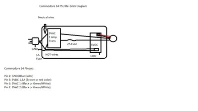

CkRtech wrote:
bjwil1991 wrote:
Tested the PSU Voltage on my C64: […]
5V DC: 5.07V (passed)
9V AC: 0.63V (failed)
Looks like a rebuild is in order (cheaper than buying a we one).
Hey - share your rebuild details if you proceed, would you?
Found a forum that has the necessary parts you need, plus the building process (YouTube videos): Commodore C64 "Re-Brick" Power Supply. The third page has the parts you need, plus the videos on YouTube as well.
PSU Diagram:
69.4 KiB
616 views
Wiring Diagram
Schematic: PSU Schematic
Another option is to keep it simple and combine a couple of power bricks - I've been using this bad boy for a couple of years now with no ill effects:
Commodore 64 revival (warning, wall of pics)
Reply 6930 of 19629, by bjwil1991
badmojo wrote:
I don't have any 5V DC bricks or 9V AC bricks, except for a universal brick that supports 3V, 6V, 9V and 12V, but that's going to be used on a radio project I'm going to be doing.
Correction: I have 2 5V DC bricks, but only rated for 1 Amp. The 5V DC line requires 1.5A, but safety must be provided if the 5V line overloads.

Reply 6933 of 19629, by gdjacobs
Slightly more elaborate (but still pretty simple) in the same vein. Get a couple of these guys:
https://www.banggood.com/XL4015-5A-DC-DC-Step … ml?rmmds=search
Dial one in to 9V, the other to 5V, feed it through a fuse to the inputs with a 12 or 18 volt wall wart good for 50W or so.
