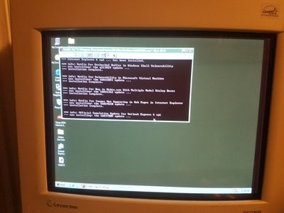

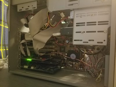

Putting the finishing touches on my Pentium MMX system. Just need to find a Voodoo 1 4 MB for it and it'll be done. 😁
Specs:
Intel Pentium MMX 233 MHz ("PCB" type)
FIC PA-2007 motherboard (VIA Apollo VP2 chipset, 1024K L2 cache)
32 MB 72-pin EDO RAM
Diamond Stealth Video 2500 PCI (Alliance AT24 chipset, 2 MB memory)
Creative Sound Blaster AWE32 Value CT4330 ISA
Maxtor 10 GB HDD (master), Quantum Bigfoot 8 GB HDD (slave)
Lite-On 52x CD-ROM, Panasonic 1.44MB floppy
Realtek 10Mbps ISA NIC
Promise Ultra66 ATA-66 IDE controller
Generic 250Watt AT PSU
Windows 98 SE
Installing a program I've found that contains a lot of registry tweaks and all of the updates for 98 SE up until June 2007.
I love the board but it has some problems, the onboard I/O refused to work so I had to stick a generic multi-I/O card in for mouse capabilities. Also, the SDRAM controller was very unstable, a 128MB PC66 stick showed up as 32 MB and Windows 98 became unstable with sticks installed. Reverting to SIMMs fixed the problems.
