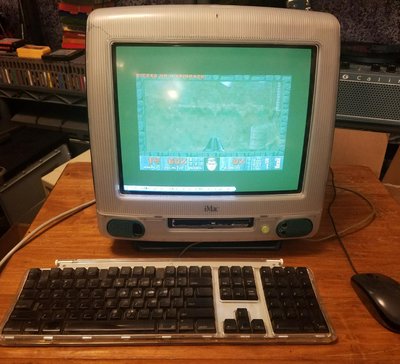

Starting to go through and repair the Mac stuff I've recently acquired. First on the bench is this Bondi blue iMac G3. It worked fine but the beige internal plastic is falling apart and I had to dump it out because whenever you moved it, it made a worrying rattle sound. 😲 It appears to have been roughly slammed down or something when I first found it because the front speaker bezel was hanging off. 🙁
I still need to find a cover for the CD-ROM drive, but thankfully it still works fine. A bit sluggish when ejecting though.
Specs:
Motorola PowerPC G3 @ 233 MHz
192 MB SDRAM (curiously, Mac OS only shows 128 MB even after reseating and switching around the RAM)
ATi Rage Pro Turbo PCI onboard video, Crystal onboard audio
Quantum Fireball EX 4.0GB HDD
Matsushita (Apple OEM) 24x CD-ROM
Mac OS 9.2.2
I threw Doom on it because the "can it run Doom?" test is essential to any PC. 🤣

Hey cool. Another Bondi Blue owner. Mine is missing the drive door and the USB panel door as well. Those things must have been very flimsy or damage prone. Another Rev.B owner too.

Those early iMacs with SODIMM SDRAM chips are extremely picky with regards to RAM. If it's showing 128MB, then it looks like it's not recognising a 64MB stick, which you can verify by removing 1 of the sticks and seeing what happens.
I've got a slightly later version of that iMac, the Rev. D 333MHz and it was an absolute pain to get it to recognise different RAM sticks I had. Ended up settling for 320MB RAM, but have other sticks to test at some point. I'm putting off further experimentation for a while, since these early iMacs are such a pain in the backside having to remove the whole motherboard just to install RAM!

Yeah, it's really a pain to have to do a partial disassembly to swap RAM 🤣 🤣 🤣

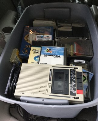

So I have emptied out most of my retro collection except for the few systems and parts I am using and was sitting high and mighty that I was finally over the vintage hoarding... annnnnd then I went on a garage sale run. Bad idea if you are trying to downsize. I found an estate sale with an old IT guy who had a large tub with 100s of floppies in it. Somehow it magically appeared in my car. There's a laptop buried in there as well. Don't know why, but I find a large stash of floppies with unknown data on them an exciting prospect. This is going to take awhile. You watch, half of it will be copies of AOL mailer disks from the 80s and 90s.
One of the stranger items in the tub is a sealed copy of sailboat charting software. Not going to be using that much.
