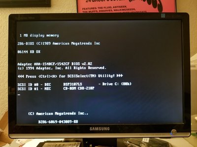

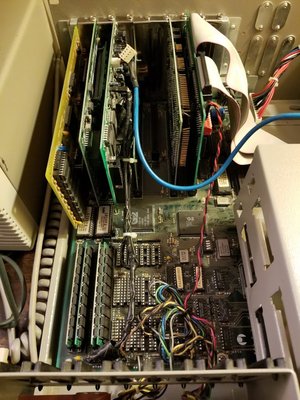

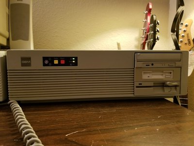

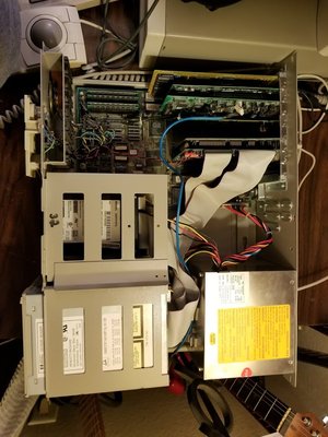

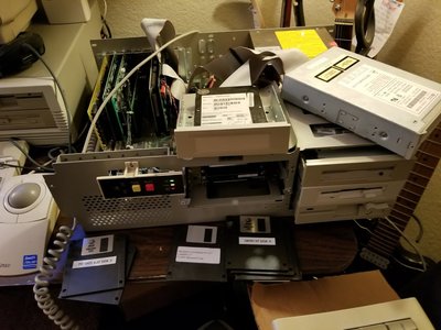

While that was going on I finally upgraded the 286 to SCSI which is probably one of the lest problematic upgrades I've done in a long time. Now I have a nice big 1GB HDD and CD-ROM on it. Time to ditch those ZIP Disks, I just don't need them and it's a PAIN to have to have 2 IDE channels in everything just so I can accomodate ONE computer in my collection for large file xfers.
So the original multi I/O Controller was taken out and swapped with one missing the game and 25pin COM ports, allowing me to confiure the card to only work as a Serial/Parallel card (COM1, LPT1). Switched the Adaptec controller to all the defaults and that became the floppy and hard disk conrollers now. Found my 1.44MB drive died, so I swaped the old crusty Mitusmi with a more reliable Epson drive I had laying around. Put the Cd-ROM in the top. Powered on the machine, did SCSI Config on the on-board SCSI BIOS, wham-o, all items came up. Next installed DOS 6.22, setup Microsoft Network Client 3.0 trying to setup for my "Linksys" Ethernet adapter only to pull the card and realize sometime ago I put a 3COM EtherLInk III in there. Setup the EtherLink III for TCP/IP with a Static IP Address, took the original hard disk, popped it into a USB to IDE/SATA converter, and copied the files to my laptop, and then copied the files to the 486 running Windows 95. Then logged in via the 286 - and basically since yesterday it's been one big xcopy party since then - now with twice the capacity so now I can put ALL the stuff I currently have that runs on a 286 on there. Also, the 286 boots faster.

    Front shot of the completed 286 after all drives and hardware installed.

    2 cards shy of a full house

    Nice top-down view into the 286's roomy interior

    YES!!

    pre-staging the SCSI controller and devices on the GEM to see if I can get them working or not
