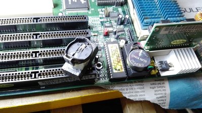

YABM
Yet another Battery mod
I had to desolder the dead Dallas 1287 RTC from this Shuttle hot 533 Mobo. Tried my new 6 euro desoldering iron, it worked better than expected.
Added the missing socket.
Then i milled the ic in the right spots,to expose the battery contacts. Battery still had 2.3 volts open circuit, after 22 years. Impressive, but not enough to keep bios settings in memory.
Couple of wires connected to a cr 2032 battery holder and all done!
1287 RTC is working again.
Made one extra from a spare 1287, just in case

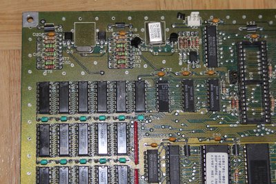

Just managed to fix my ATARI PC3 XT Mainboard from this lot:

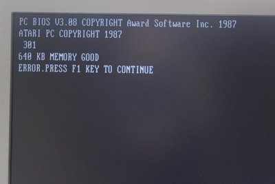

First replaced the 2 bigger caps, no change. Then I noticed that the 14.3 MHz crystal was bend, but looked still OK. I replaced it anyway...and 😎 😎 😎

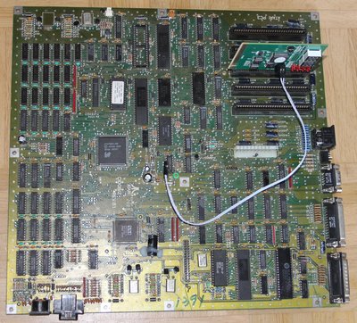

Didnt have the correct spare part, but no reward for the nicest repair here 😉
1.42 MiB
1212 views
What to do with it? Back in the box. It has a custom form factor and is of no big use if you dont have the corresponding case for it...maybe I will sell it at Ebay.

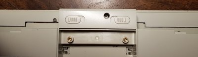

Spent some time over weekend dismantling and examining my three Siemens-NIxdorf PCD-4NDs. Despite having bought three of them in various states of decay in order to make two working ones, I'm struggling. Each of them has different build! One has IR port, two don't. One is DX4/75 without heatsink, one is DX4/100 with heatsink, one is DX4/75 with heatsink. Two have soundcards, one is mute. One of these two has working speaker, the other one doesn't. One screen is broken TFT, one is working TFT, one is DSTN with such incredible lag that I am considering keeping the broken TFT one instead.
And the one that has best config has one broken screw and I cannot open it. Argh. Any protips on screws that won't budge?

Drill it out . Use a drill bit that should be the same diameter as the shaft itself. Then drill just enough so the head of the screw pops off. You can probably then use a pliers to extract the rest once you have the case off. If not, then it is drill and re-tap the hole time.
In order to keep the heat from drilling from melting the plastic, use a drop or two of liquid in the hole. It will also help it cut he metal easier as well.

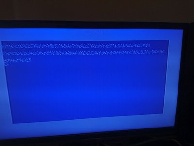

Now there's only one thing left to do; trying to figure out why the text sometimes, seemingly at random, is replaced with "noise blocks" when booting the computer. It's always been like that, but back in the day, a simple reset would usually do the trick. Now it seems to be worse, got to power it off and let it sit for a while before powering it on again for it to show the text correctly. It looks like this:
73.51 KiB
1116 views
Any ideas?

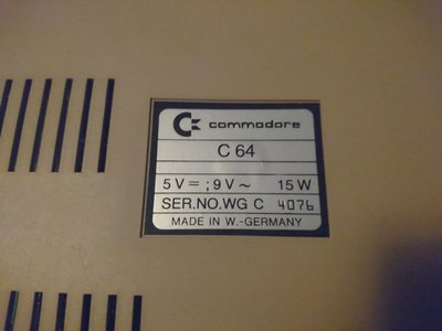

By the way, anyone here got a C64 with a lower serial number? 😁

My 2 cents American would say it's either the PLA chip, VIC-II chip, Kernal chip, or RAM.

Been thinking it has something to do with the character ROM or its support circuits. It's very odd that the problem is intermittent. Also, it's been this way since the computer was brand new iirc.
Might also add that loading games still works perfectly when the text is garbled, and those will not show any graphic corruption whatsoever.
Can't find anything on the Internet about this problem. On the other hand, I hardly know what to google for either :>

Thank you for the pro-tip, I wouldn't have thought about it. I will try to do this today in the evening and will let you know how it went. Thanks!

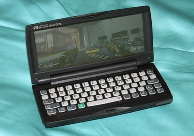

played some oeuvrewatch on an HP Palmtop
