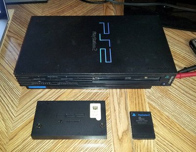

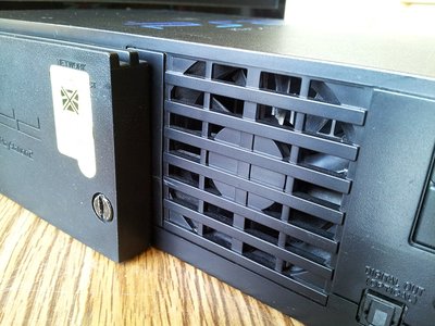

I finally got a HDD/network adapter and Free McBoot memory card for my O.G. fat PS2, so I busted it out. This thing's had a hard life & was apparently treated pretty rough by previous owners, but it works 100% flawlessly and the DVD drive is super quiet, so I want to keep it going and give it a comfortable, gentle old age. 😀 Naturally "installing a HDD" turned into a full-on teardown and cleaning.
266.53 KiB
1364 views
154.62 KiB
1364 views
^^ Sony, helpfully warning you not to plug a phone jack into the network port. I guess somebody had to try it... Incidentally this is a JDM network adapter, the North American one includes a modem. I figured the chances of me using a modem on a PS2 are literally 0%, and this was local and cheap.

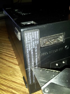

Step 1: void the warranty. It's amazing how many of my dumb projects begin with this step.

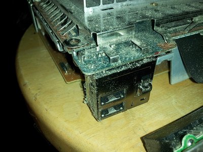

Got it apart, and:
254.76 KiB
1364 views
Eww...
234.84 KiB
1364 views
EWW...

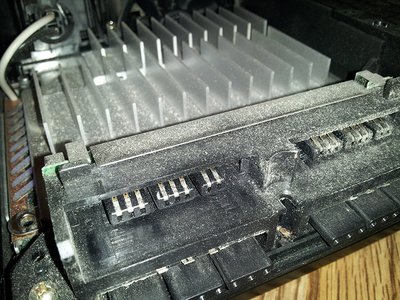

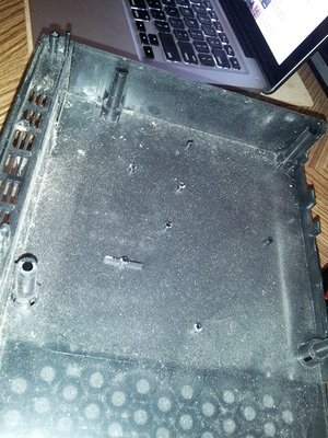

Reply 9241 of 27581, by xjas
200.07 KiB
1364 views
OGOD.
225.13 KiB
1364 views
Hell. No.

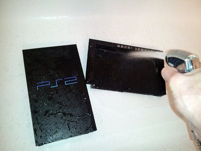

...actually it wasn't that bad, but I figure that dust isn't helping anything. The outer case was easy to clean:

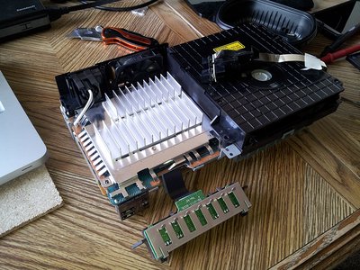

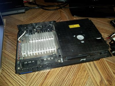

The inside is kind of a board sandwich. My original idea was to disassemble everything, vacuum it out, replace the 2032 battery and re-apply all the thermal goo, but when I saw how tightly it was put together and considering it was working perfectly when I pulled it apart, I sanely decided to scale back my plans.
Incidentally If your PS2 isn't keeping time and you want to replace the clock battery, it's predictably located on the motherboard between both RF shields. You pretty much have access to it at the very last stage of total disassembly. Sheer genius, Sony.
Even though I stopped taking it apart at this stage, the vacuum & canned air blaster did a pretty good job of the "organ block":

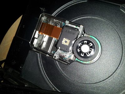

And I took the opportunity to clean the DVD tray & dust off the laser:

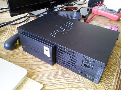

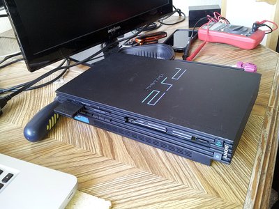

Back together and looking good!
265.92 KiB
1364 views
260.29 KiB
1364 views
183.86 KiB
1364 views
No HDD in there yet - I seem to have depleted my stash of spare IDE drives lately, although I have an 80GB in a test machine that'll go in there once I dig it out. You can order 3rd-party SATA adapters off Ebay but like I said this was local, and cheap.
Another system modded!

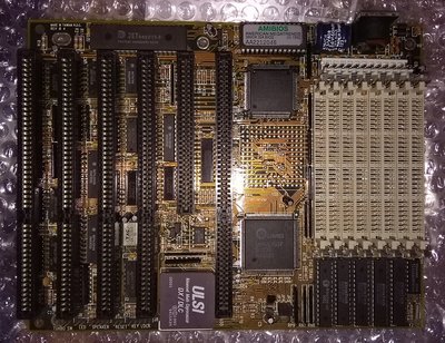

Need to desolder that bad battery and clean up a little corrosion, but I've seen worse. In case it's not clear, it's an AMD 386/40. Odd layout, very compact, lots of ISA slots. I *might* be able to fit a 1/2 AA 3.6V battery in there, but probably not a socket for one.

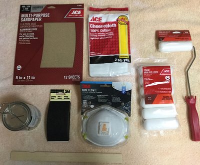

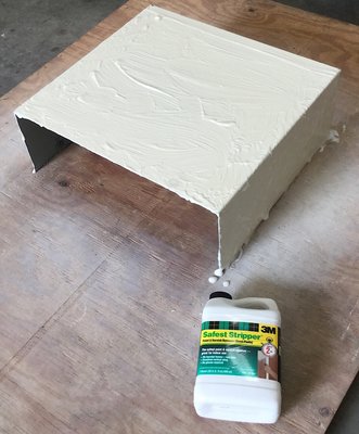

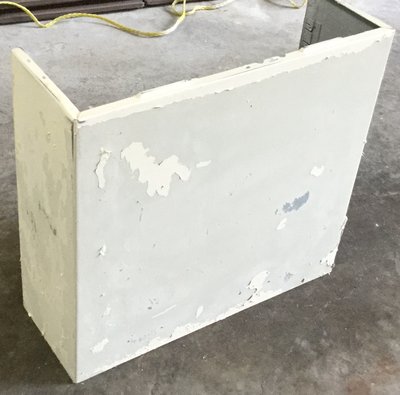

Reply 9246 of 27581, by liqmat
lvader wrote:
I’m quite interested in this because I have a couple of case covers that need a paint job. i havn’t experimented yet but getting the right paint gloss level and colour is probably key.
You know that nightmare where you are running down a hallway and the hallway keeps getting longer and longer? Yeah, I'm still running.

Reply 9258 of 27581, by liqmat
After a 24 hour wait the paint remover stripped 4 coats of spray paint off and I see some raw metal. One more coat of paint remover overnight should get me a bare metal case shell. Then time to paint on the new enamel coat.
