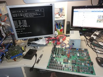

I managed to revive a Commodore PC20-III motherboard from dead. Took lots of probing and prodding, but I managed to catch everything buggy. I had to change all of the RAM chips because all of them was damaged in quite weird fashion. When I fed them series of 0s, it gave back 0s. When I gave it series of 1s, it returned 1s. But when I tried 1010101010s, it always returned 1s. And by the way - all of them was soldered onboard. That was HUUUUGE pain in the butt...
Also I had to change one 74S08 logic chip which generates /RAS signals for the second half of bank of 256×4 DRAM chips which of course prevented the whole bank from being properly recognised. And finally the board POSTs with all 640K of RAM. I think I was never so happy 😁

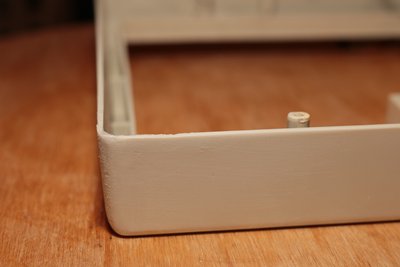

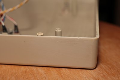

Yesterday's case repair turned out very nicely 😀 All the screw posts are solid and the crack marks are hard to see so no point painting it.

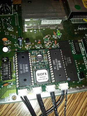

Pulled apart my C64c to install this hotness:
270.17 KiB
1247 views
^^ that's right, 6581 (R4AR no less) & 8580, in the same machine.
196.7 KiB
1247 views

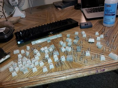

Unfortunately I noticed it was a little grungy on the inside. Of course this "quick install" turned into a full-on 8-Bit-Guy style teardown and clean.
246.25 KiB
1247 views
Blarglgrarg.
The metal shield also needs some dremelling, which will happen tomorrow since it's 2AM and my neighbors get mad if I use power tools during their magic sleepytime. Philistines.

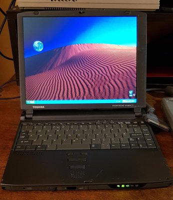

Spent some time dusting off and bringing old(ish) Toshiba 3480CT back to life. Installed Windows XP from external DVD drive and as Dr Frankenstein once said, it's alive!
136.94 KiB
1244 views
Also, already installed Pico-8 and it runs, albeit slowly. That is going to be a fun challenge to program that thing on less-than-minimum hardware!
Next steps are to install SP3, try to find working Focus Writer version (despite what many sites are saying, new versions are not compatible with Win XP), install Unreal Tournament and Deus Ex, try to get my iFeel MouseMan drivers and games working together and have a retro early WinXP station with force feedback.
If all goes nicely and I actually start using it more than occasionally, I might invest in SSD drive and a new battery. We'll see about that, though.

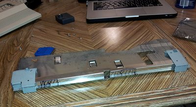

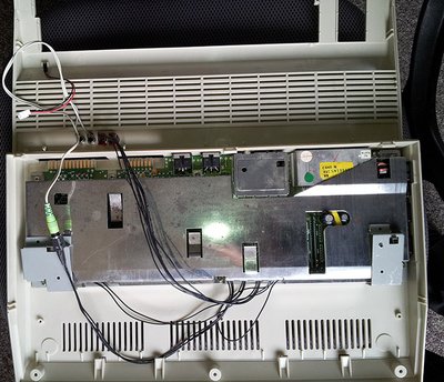

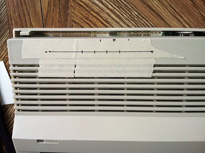

I wasn't really trying to document this as I went along, so pics are a bit sporadic, but here's the rest of this little project.
188.13 KiB
1146 views
188.4 KiB
1146 views

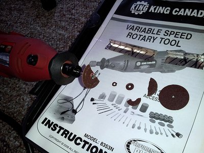

^^ My low-budget dremel made quick work of this metal shield, but the metal shield also made quick work of several cutting blades. 😜
173.48 KiB
1146 views
176.93 KiB
1146 views
The main reason for doing the mod: 😁
180.14 KiB
1146 views

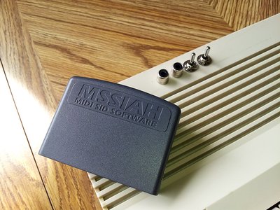

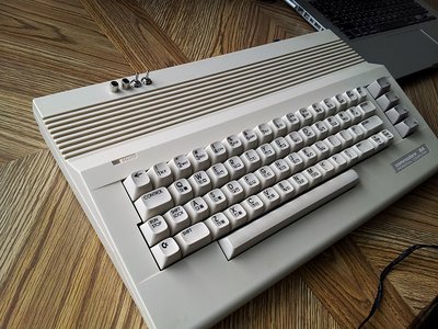

And all back together! The two RCA jacks output each SID individually; the switches control the operating modes of the SIDFX. I think the result looks pretty neat:
230.62 KiB
1145 views
^^ The cleaning effort was well worth it too.
Haven't tried it yet as my PSU for this thing is REALLY sketchy. I'll be picking up a brand new one from a friend soon.

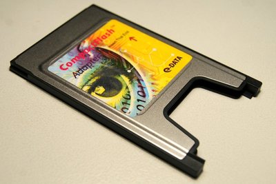

Good question! However, I can't find anything on the manufacturer, e-Data, on Google.
The card is simply described as a PCMCIA CF Type 1 to PC Card adapter:
123.24 KiB
1061 views
But, yeah, it works quite well, is hot-swappable thanks to the PC Card standard and for file transfer it beats unscrewing the HDD caddy with it's proprietary Toshiba IDE connector!

Yeah not SD but CF adapter. SD wasn't a thing until PCMCIA was well on the way out. CF adapters were plentiful and cheap because they don't have any electronics inside, they're basically just a physical connector converter and just leave all the work for the PCMCIA chipset in the machine.
