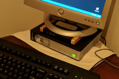

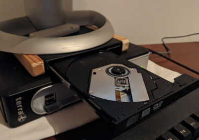

Took an old IDE Laptop DVD-ROM drive, bought a 50-pin JAE to 44-pin IDE adapter and an enclosure and built some wooden standoffs, so that the monitor doesn't apply pressure on the DVD-ROM drive. Now my thin client PC has an optical drive. Right now I'm interfacing it with one of those USB-to-IDE adapters (in Windows XP), power + data over one USB port (although I tried with another DVD-ROM drive and that didn't spin up with just the USB power).
The thin client does have two on-board 44-pin IDE connectors, so once I find some long enough 44-pin IDE cables, those can be used. Maybe even with CD-ROM driver + MSCDEX in DOS (since it should be just another IDE CD-ROM)? The JAE-to-IDE adapter does have the 4-pin CD-Audio header, too, so combined with a SB Live!, this could even allow for CD-Audio over the soundcard in DOS, but DOSBox in Windows XP is just a bit more convenient for now..
The height of the thin client allows the DVD-ROM drive to open nicely above the keyboard.

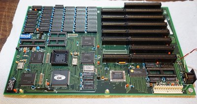

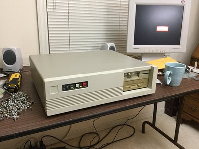

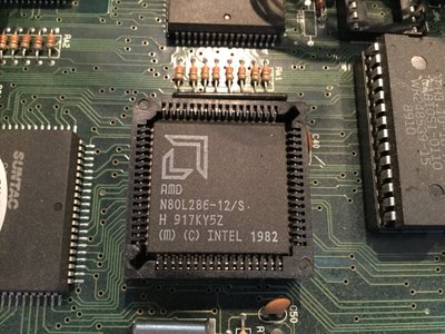

About half way through a 286-12 cleanup. Found this one in a large lot on Craigslist. Out of the ten machines in the lot, this is the only one I was after. Have been cleaning it since yesterday. Neutralized a few small rust spots on the metal case and primered those spots. They were all internal so no need to paint over the primer. All socketed chips were removed from the board before it got a dip in the bathtub and scrubbed with a soft bristle toothbrush. Once I dip my PCBs they get a towel dry and a blast from my air compressor to remove any excess moisture and then a blow dryer treatment. After all that, I still let them sit for 12 hours for a final air dry. Every inch of this machine has been cleaned and now things are starting to look good. Glad to report the motherboard pulls right up. Just waiting for a MFM and floppy controller to arrive which was missing from the system. I decided to just clean up the floppy drives and not replace or retrobright them. Keep that vintage "I've been around the block a few times" look to it. The case has a few spots where the paint is wearing off and that's ok too. Overall, very happy with the results so far.
What a beautiful machine! Warms my heart to see it getting the respect it deserves well done.

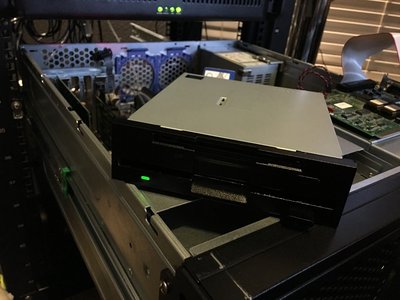

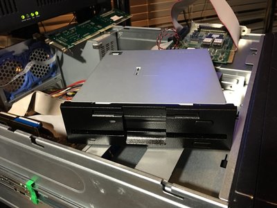

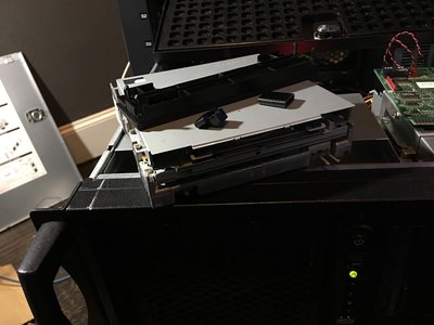

Finally, after ~25 years of yearning for one, I received my first tandem floppy drive. (3.5" & 5.25" combo in half-height bay form factor.)
Unfortunately, the only one for sale on eBay was beige: https://www.ebay.com/itm/Teac-FD-505-5-25-Dua … 5.m43663.l10137
(Since I purchased this, two more have gone up for sale on eBay -- different from each other and different from the one I got -- but both beige.)
My DOS gaming setup, which is still evolving, consists of four different custom rackmounted systems ranging from a 10MHz XT Turbo to a Pentium-II @ 350MHz. In particular, the 486 system could use this drive so that the 3.5" bay is freed up to accommodate a custom turbo switch which is obviously not available on a rackmount chassis.
...and all of these cases are black, by my choice...
So, I had my wife(who is a world-class artist) paint the bezel black after I very carefully removed it and stripped the 3.5" flap, spring, both LED covers, and both eject button covers.
Then, I touched it up with some of her black nail polish so that there's no hint of beige visible.
...and finally re-assembled it, hooked it up, and tested it. Success!
The drive only hooks up to the multi I/O card as an A drive (with the twist in the cable), but it simulates the B drive being on its own cable, which is amazing.
I couldn't be happier with this.
On an interesting note: This is the only 5.25" floppy drive I've ever seen that has a push button for an eject mechanism(like a 3.5" drive) instead of a 90° knob that locks the floppy in place and/or ejects.

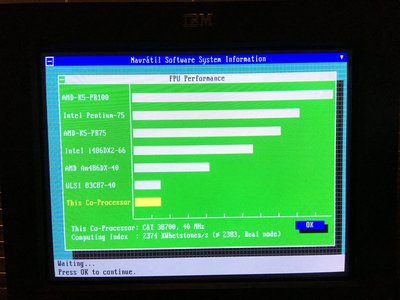

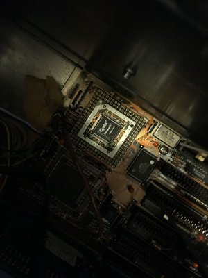

Again, after ~25 years of wanting one, I finally got my hands on an x86 FPU -- a Cyrix Fastmath cx83d87-40-gp to pair up with my Am386DX-40. I was hesitant to install it because I haven't been able to find the manual for my motherboard, but I inferred from the available evidence that the correct orientation for this chip is 90° counter-clockwise from the 486 CPU corner mark on the socket on the motherboard that can accommodate either a 486 or a 387(or equivalent).
Turned it on, hoped I wouldn't smell the magic smoke escaping, and lo and behold: (see attachment)
Minor dream fulfilled. Now to re-compile my old Mandelbrot generator code to target the 387. 😎

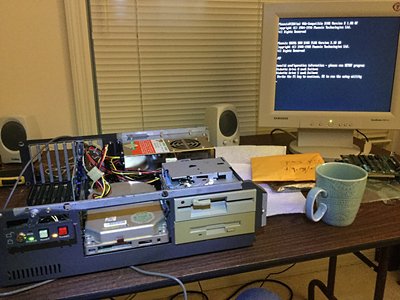

Currently testing a SB32 CT3600 and a Turtle Beach Pinnacle Rev F I just received (With HOMAC board and SPDIF board!)
