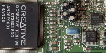

Reply 33 of 53, by gerwin
Abundant? not really, unfortunately..
When I wrote "CT2940 with OPL3-L" I did so to differentiate from "CT2940 with CQM (CT1978)", the latter being more common.
The CT2950 with OPL3-L is more rare.
If you care for OPL3 then try to recognize the difference before buying, by looking at the chip placement.

Reply 35 of 53, by gerwin
No, cornered between the crystals and the main chip we find the CQM chip.
The OPL3-L area is empty.
A quick search on ebay.com gives me no CT2940 or 2950 with OPL3-L.
This image shows the OPL3-L area filled:
    51.53 KiB
    1770 views
    OPL3-L
Reply 36 of 53, by King_Corduroy
Ohhhh! Sweet ok, yet again you have saved me from wasting my money. 🤣 Thank you.
