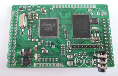

Reply 33 of 109, by dreamblaster
hello,
the next generation board is ready : dreamblaster X1
i have 4 working prototypes, software is almost done (for waveblaster compatible mode).
Any midi files you like me to play on it as a test ?
    137.56 KiB
    1597 views
    dreamblaster X1
Thanks for your support !
