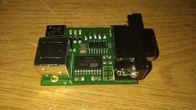

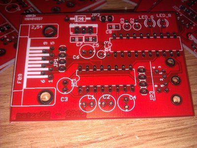

Hi,
i want to show you a Project im working on and that i want to share with all Retro PC Users, its based on Simon Augustins old RS232 PS/2 Project.
This Device allows you to drive many Optical PS/2 Mouses on Serialports with Microsoft Serial Mouse Driver.
It drives me Nuts to use this Old Mechanical Mouses often with issues, bad moving speed, not ergonomic...
This is the Solution to give your trusty old 286/386/486 a really handy mouse.
The Firmware is rewritten by Felmar Loyd, and works now in Logitech Mouse Mode.
- Wheel Mouse Support
- 19200 Baud Turbo Mode (KVM Speed bump)
- Logitech / Microsoft Protocol Switchable
Also Available from Serdashop: https://www.serdashop.com/PS2TOSERIAL
Note that this is not my Shop 😀

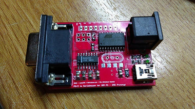

SMD Prototype
160.51 KiB
8068 views

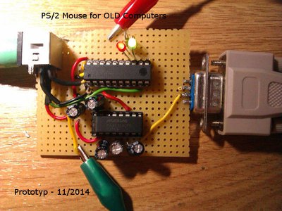

Prototyp 1:

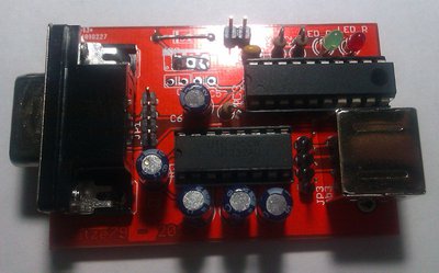

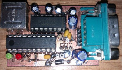

Prototyp 2:
97.94 KiB
17435 views
Video 1:
https://www.youtube.com/watch?v=xSLEmDo5Hbc

Reply 1 of 381, by matze79
Here is the Schematic and PCB Files in current Version.
All Files are GPL v2 Licensed.
Thanks!
EDIT:
Obsolete - All Files are on Github now

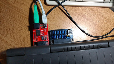

Some Progress:
124.47 KiB
17250 views
Co2 - for a endless Summer

Reply 10 of 381, by matze79
its possible that something isnt 100% perfect, as i just try to teach things myself 😀
i'm currently writing with the original author of the avr source code to license it under gpl, so this will eventually become a Community Supported Project and the Firmware will get some improvment, its also possible to add a bootloader to the avr to allow updating over RS232 directly from Windows or DOS.
But some mouses seem to have Problems with the timeout issued by the bootloader.
Thanks for fixing the Issues within the Files.
i'm currently using dirtypcbs.com which also offers shipping and sending around the world, a minimum order would be 10 pieces Protopack for 25$.
If you like you can add the pcb to oshpark too.
i waiting for the parts to arrive to make a test build with the PCBs, and get eventually some final fixes.
Sorry for wrong grammars 😀

Reply 16 of 381, by matze79
79.9 KiB
16951 views
Build works 😀, no Errors in the PCB Design!
Everything works! I´m Happy!
