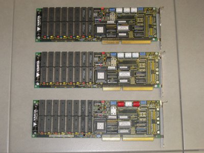

I was dumpster diving a few days ago. Got these ISA cards. Anyone knows what were they for?
Battery backed RAM is what they look like to me.
Possibly for some nice RAM drives on an old system.
Yamaha YMF7x4 Guide
Epstein didn't kill himself
Reply 2079 of 3190, by bjwil1991
Heck of a lot of batteries for 1 card (3x NiCd and 1 Lithium).
