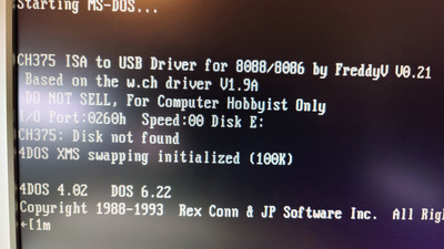

FreddyV wrote on 2022-06-17, 20:01:
Did anybody test my driver ?
I have tested your drivers v0.21 on my 80286 10Mhz.
I tried with the CH375V86.SYS, CH375V88.SYS and the CH375286.SYS. Sadly none of them worked. I got the exact same error on all three drivers. See picture.
Suggestion: Maybe you should have a text in each driver telling which version (88,86 or 286) it is.
My original CH375dos.SYS works. I only have versjon V1.9 (and 2.0A) - Not the V1.9A - Maybe you could upload it?
The USB stick is formatted as Fat16 with 991MB

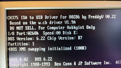

Here is the V0.22 Driver version, with 286 supported and some small changes.
30/06/22 V0.22
- BUG Fix : IRQ and Speed parameters were reversed, so the Speed was 3 by Default
- 286 Version tested on 286 8MHz
- Some Useless code removed
- Added some display : DOS Version, Chip Version, Partition number

By mistake i tested the CH375216.SYS - on my USBISA card i bought on AliExpress. It works on my 286 10 Mhz machine. I copied PlanetX3 fropm USB to CF. 566KB tok 46Sec. Speed = 12KB/Sec.

Reply 90 of 167, by Jinxter
FreddyV wrote on 2022-06-30, 20:19:
I just tested the CH375286.SYS. v0.22 It works on my 286 10 Mhz machine. I copied PlanetX3 from USB to CF. 566KB tok 36Sec. Speed = 15,7KB/Sec. The original driver (V2.0A) was 9,25KB/Sec. And original V1.9 (no A) was also 15,7KB/Sec.

Reply 93 of 167, by Jinxter

Reply 94 of 167, by Jinxter
FreddyV wrote on 2022-07-13, 14:48:
Jinxter wrote on 2022-07-12, 16:35:
Can you test with disktest ?
With the new disktest i got very good results. Check out my video on the speed test: https://youtu.be/A37MQ0HgEpE
