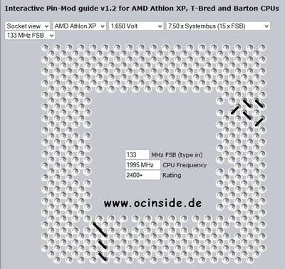

Reply 31 of 31, by RetroBoogie
Quick update for anyone who may find this information useful.
So I ordered a 2400+ Thunderbird after much research about my KT7A-RAID v1.0. When it arrive, I tried it out and the system wouldn't post. According to the Athlon cross multiplier table, the 2400+ runs at a 7.5 (x15 HI) with 133FSB, giving 2.0GHz. Well, for the life of me it wouldn't work. If I reset the BIOS, it boots up as unknown CPU at 20x100 (2GHz), but I want my 133FSB!
To cut a long story short (and the frying of my Thunderbird 1.2 GHz 🙁 ), I found a site that had an interactive pin modding tool. You select the CPU, voltage, FSB, and desired multiplier, and it told you which pins on the CPU, socket, or mainboard to jump. In the end I found the socket wire mod the easiest for me, and using kynar wire I constructed 9 small jumper wires that I carefully inserted into the socket according to the diagram. Success! Boots at 2GHz, (15x133) and after reinstalling Win98SE from scratch everything seems great and really fast. Here's a screenshot of the interactive tool:
136.64 KiB
1071 views
In the BIOS, I had to change the multiplier manually to 12andabove, CPU/FSB clock to 133/33, and CPU drive strength to 2. Really breathed new life into the system and definitely takes advantage of the Ti4600's extra horsepower. I also installed the Via 4in1 v4.35 pack, Via Latency Patch, and Detonator 43.45.
Perhaps useful for anyone looking to put an XP into an old KT133A board.
