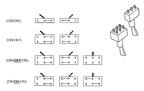

Reply 112 of 137, by falloutboy
You can try CPUFSB first, if it's not working go for the switch solution.
This is how I did it.
Just get some cables, you can use IDE, Floppy cables or even old analog audio CDROM to sound card cables.
Or search for "jumper cable 2.54MM male to female 1P 30cm" or something similar
e.g. something like this http://www.ebay.com/itm/40pcs-Dupont-Wire-Jum … =item3f2cbece60
The female side will fit on your motherboard jumper connectors.
Search for "Mini Toggle Switch ON ON" or something similar.
I use one like this http://www.ebay.com/itm/3-x-Mini-Toggle-Switc … =item3a62199893
or if you like to have every jumper separate adjustable
http://www.ebay.com/itm/10pcs-Mini-MTS-102-3- … %3D290638075909
You may need to use a solder iron for the switch cable connection & to extend your cables.
And you have to drill a hole somewhere.
Have fun 😀
This is what you usually get for cheap money.

Reply 115 of 137, by PhilsComputerLab
Ah just checked, I was confused, turns out most boards do indeed use jumpers for the FSB 😊
But DIP switches for voltage and multiplier.
So yes, sounds like a great idea!
It's added to my project list. Maybe for an improved 4 in 1 machine, you know, compile some findings and things like that.
The GA-5AX and AOpen AX59 Pro have two jumpers that need changing (1-2 to 2-3) to switch between 66 and 100 MHz. I will test if your method works with these boards (removing the pin = one of the settings). That would make the mod super easy, which just a single switch that closes two circuits. Double-pole or double-throw (DPDT) switch, is this what I should be looking for?
Something like this: http://www.ebay.com.au/itm/2-Pcs-ON-ON-2-Posi … =item339fedcd3b
The DFI K6XV3+/66 does use DIP switches.
YouTube, Facebook, Website
Reply 116 of 137, by falloutboy
philscomputerlab wrote:
Yes, they will work perfectly. My switch is like ON OFF ON, with a middle OFF position but that is unnecessary.
