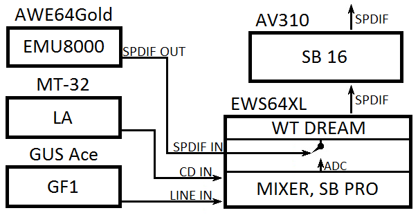

PARUS wrote:
Signal Lines Connection. ----------- ------- --------- GUS Ace MT-32 64Gold ----------- ------- --spdif out | […]
V V
analog in
--------------------spdif in
EWS64XL
--------------------spdif out
| s/pdif
V
--------spdif in
AV310
--------spdif out
| s/pdif
V
Digital Receiver DAC Amplifier.
This is my best DOS sound system.
This text is uneasy for looking and reading. It's better to see this picture:
That's right.
Hmmm.... Does it run DynaBlaster with full sound?

Reply 78 of 137, by PARUS
brostenen, I'm not sure that DynaBlaster or any other game before 1993 will run on my Core 2 600MHz without issues. I said my system is mostly for 1993-2009 and I think that it has 100% or very close to 100% compatibility with this "era".
But I can to try. Firstly it should be without sound and if it will run without any issues then I'll try to play sound.
When I talk "it's my best DOS sound system" I mean other things at all. Most ISA cards have a terrible analog lines. When you listen by good acoustics the S/PDIF quality difference... Well, must to hear 😀
