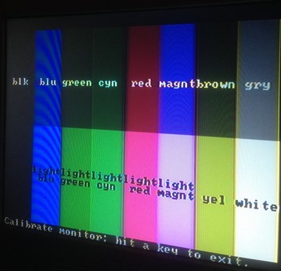

I was researching why an ATI Small Wonder delivers wrong colors when connected through composite and I couldn't believe I found the exact thread with answers here 😀
I don't have (or it's likely to find) a color RGBI monitor, so my intention was to just use the composite connection to a LCD TV monitor.
First of all, is it normally that bad? (I've never seen CGA composite live before but it's way worse than using RGBI).
191.39 KiB
131 views

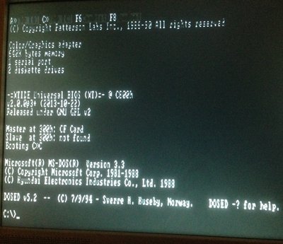

Are clones known to have problems displaying the correct colors in general when using the composite connection? I mean even in 16-color text mode. For example this is how the standard colors look like (hue untouched, adjusting it can bring it pretty close to the correct colors):

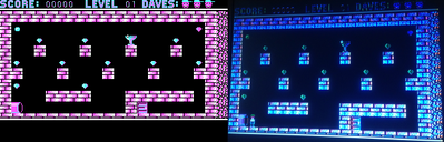

Of course magenta being blue causes Dave Dangerous to appear like this (the game doesn't have any special composite color mode, just uses one 4-color palette).
140.71 KiB
131 views
I'm mostly trying to figure out if there's something wrong with my card, since even standard palette colors are off. I don't mind if this ATI displays things like that when connected through composite, as long as it's the normal behavior of the card. I'll call it a feature 🤣
