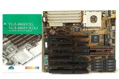

what kind of graphics card would i need for a board like this? (not this EXACT Board but a similar board.. )
ie: if u could give me a hint on what to search for .. do i search for VLB? or VESA? + "Graphics" ?
how do i know if a board support "intel overdrive" cpu?
i cant even look up which cpus are supported by most of these boards!!
sorry for all the questions but im really trying hard to make sure i do this right the first time. + order the right things that i need...
i did some searches + saw that people want 200$ for ISA ATI video cards... thanks to idiots over pricing 486 stuff on ebay.
    614.6 KiB
    1080 views
Reply 38 of 130, by soviet conscript
Any isa i/o controller should work or vlb controller if you get a board with vlb slots. Overdrive compatibility depends on the board, you would need to research. Most should work fine in my experence. Look for graphics cards based on the tseng labs et4000 chip. Cirrus Logic put out some decent video chips as well. Vlb versions will be faster in general. Isa cards based on the trident 8900D chip are suprising fast for being a trident card.
