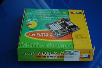

im trying to figure out the last cpu/mobo chipset combination that actually provided proper windows 3.1 driver support
would it be a PIII? or a PII? or a P1?
would the cpu be too fast to run a 533mhz celeron in a 815E chipset PIII mobo?
http://ark.intel.com/products/27189/Intel-Cel … ache-66-MHz-FSB
do boards with 815E support windows 3.1?
ok i just checked the asus site
http://support.asus.com/download.aspx?SLangua … s=&hashedid=n/a
it lists drivers for win95 but not windows 3.1
is it possible to use hardware drivers from win95 in windows 3.1?
i think i remember reading something about the win95 + win3.1 drivers being compatible with one another?
or does that only go in one direction? forward not backward.
what would be the last intel chipsets to support win3.1 officially?
if my memory serves .. i think support for win3.1 lasted up untill about 1997..
and then started fading fast..
could it bethe 430TX?? (february 1997)
or possibly the 440BX (1998)?
i think there were some AGP cards that had drivers for windows 3.1? wasnt there??
which would mean there must be some support for win 3.1 in the 440LX + 440BX chipsets
