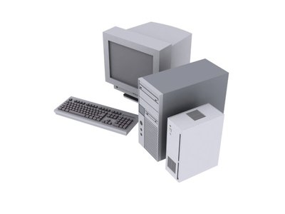

Hello,
I am trying to design and make a custom PC case for mATX mainboard, with DC/DC power supply so it will be powered using external power brick, in order to minimize the size, and which will have ISA sound card, P3 1GHz or better, Voodoo (or V2), low profile ISA sound card, laptop CD and FDD drives.
31.67 KiB
398 views
It will have dimensions of about 11x230x300cm, so it will be much smaller than mini-ATX case, I will be able then to put it next to the monitor on my desk, or under it and use KVM switch with that.

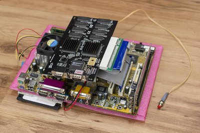

To sum up, i am trying to build an ultimate small-sized Retro-PC for games from 1990 to 2002, using Win98. I want to mount the Voodoo horizontally, using PCI extension cable, and maybe do the same with the AGP card (but i would like to use something low-profile)
318.88 KiB
398 views
(i used different mainboard on this photo, but it has the same size)
I am using MS-6198 mainboard with Via694X chipset in mATX form factor (it has built-in memory interleave option so you dont need to use viaenabler patch, that's great, 430/480 memory bandwidth),
and it seems it has problems with newer graphic cards. It is rock stable with GF3 Ti200 with passive cooling, i ran 3dmark2001 for several hours and no crashes at all, and it gets around 4600 pts, which is pretty good (it can even run GTA:SA in 800x600 with pretty smooth framerate), but the problem is that this card is pretty big and I would have to put it horizontally, just like Voodoo, and using both cards in such configuration could make some airflow problems.
I bought used low-profile Radeon 9600 Mobility AGP card (yep, that's true! its mobile version...), which has passive cooling and gets around 6000 points in 3dmark2001. But, the problem is, that it causes the computer to freeze a lot... 3dmark is locking up after few minutes of testing. I had similar problems with GF6200 64-bit, so I guess that graphic cards without 3.3V signalling and with AGP 4x or 8x native support are problematic. I had forced the mainboard to use 2x AGP in BIOS, or even 1x, but it didn't help.
Does anyone have such problems in motherboards with that chipset? I have updated the BIOS, tried to use manual AGP comp driving setting but I couldn't find good settings. That GF3 is fine, but I would like to put something smaller with similar performance, in order to improve the airflow, and I would have to use more modern graphic cards. Are there any other passive cooled cards, which will be as good as GF3, but in low-profile form and compatible with that mainboard?
Reply 2 of 3, by F2bnp
I am using an FX 5700 on a Via 694T without any issues, I think trying a GeForce FX card is a good idea, as long as it is not the really low end ones like the 5200 and 5500. An FX 5700 for example is just as fast as a GeForce4 Ti 4200+ and will allow you to enable AF and maybe some AA on older games without the huge performance impact of the previous generations making a lot of older games look nicer in the process 😀.
Reply 3 of 3, by shamino
At one point I had a Quadro 980XGL (Ti4600 equivalent) apparently working fine on a motherboard with the VIA 694X MP. I believe I ran 3DMark 2001 on it, but it's been a long time so I'm not totally sure.
I have a Quadro version of the FX5500 that I could try. I don't remember if I ever tried it on that board before and I know the card is working. I have an FX5700 but it's suspected to be faulty.
The card that I've had issues with on that 694X chipset is the 7600GS, which is an Express GPU bridged to AGP. It has rendering glitches in some games/3DMark2001. It doesn't happen in everything, and it's repeatable when it does happen, so I think there's some incompatibility that only certain functions or whatever provoke. The card works fine on a later era motherboard.
