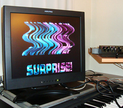

Reply 3 of 69, by xjas
Monitor: EUC AGN PRO EP19AV
Native res: 1280x1024
Scaling: very sharp filter, minimal "pixel smear"
Aspect rto: 5:4
Inputs: VGA (used for testing), Composite, S-Video
Machine: Thinkpad 365ED
Video card: Chips & Technologies
UniVBE: no
Tested by: xjas
OVERALL COMPATIBILITY RATING:
15 / 14 - beyond amazing
  Application          P   F   CP  Notes
| Ambience | | | X | Worked after down arrow (decrease refresh |
| Luminati | | | X | rate) pressed a few times. Seems to go out |
| of range around 87 Hz. |
| Timeless (56Hz) | X | | | |
| Timeless (60Hz) | X | | | |
| Dowhackado | X | | | |
| Kukoo2 | X | | | |

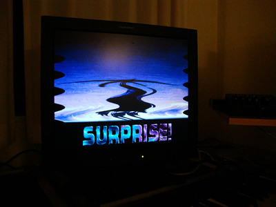

| Copper | X | | | THE WOBBLE WORKS. |
| Sunflower | X | | | |
| Yo | X | | | |
| Impulse Tracker | X | | | |
| CubicPlayer 132x43 | X | | | |
| Tweak 256x256 | X | | | Every single mode in 'Tweak16' works. Even |
| Tweak 360x480 | X | | | the notoriously difficult ones. |
| Tweak 376x564 | X | | | |

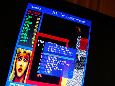

| PAL-on-VGA | X | | | Somewhat squashed, aspect ratio wrong. |
| NTSC-on-VGA | X | | | "" "" |
Other notes:
EUC (not AOC) make monitors intended for the CCTV / security industry, so I imagine they're not overly common. I picked this one up from a local classified ad for all of ten bucks. I don't think I'd be exaggerating if I said this is the best LCD monitor for DOS applications I've ever seen. The slightly-dodgy-translated blurb from the official website says it all:
" Enhanced Video Signal (EVS) Input monitors provide the highest compatibility with CCTV equipment and enhanced video clarity. Unlike many flat panel monitors designed for the PC industry, EVS enabled monitors will not experience dropped signals as a result of video signal hunting. Dropped signals and poor composite video quality have made most flat panel monitors (designed for the PC industry) difficult and undesirable to use with multiplexers and digital recorders. [...] "
This thing is very quick when changing resolution / display modes. Naturally, while I did all the testing on VGA, composite & s-video modes work great as well. It's even useable with LCD shutter glasses (DIY SimulEyes clone) although with significant ghosting and your head must be held at 45 degree angle so that the polarization doesn't black out the screen.

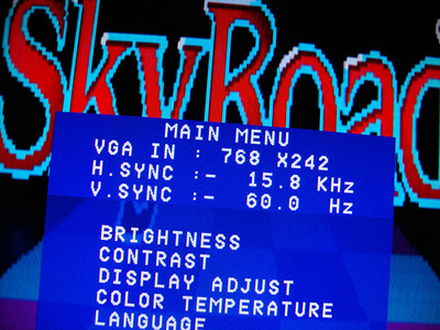

^^ This is pretty much the only photo I need bother posting. Everything that needs to be said is said right here. Nonetheless, here are some more pics...

2839 views
The beast in question.

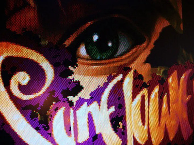

Beautiful fakemode presentation in Sunflower.
Every single mode included in Tweak16b worked fine. ALL OF THEM.

NTSC-on-VGA

Jill in PAL-on-VGA. Aspect ratio in these modes was a bit wrong. You can probably adjust this out manually.

| Sunflower | X | | | some vertical banding but looks nice |

nice fakemode rendering in Sunflower (click on latter image and notice the vertical banding)
