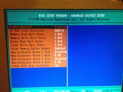

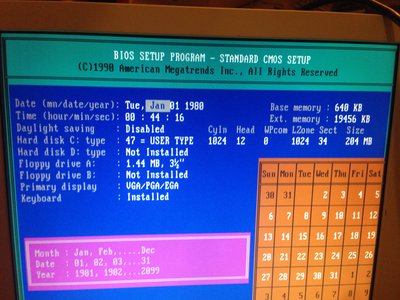

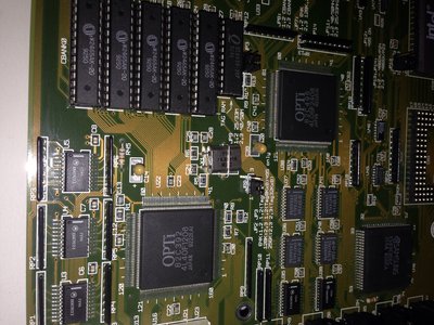

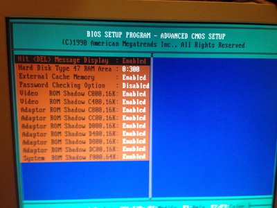

So, I have a new 486 machine that's giving me some trouble. When I tested it in the thrift store it booted into Win 3.11 perfectly fine, but also made note to bark at me for a dying CMOS battery. So, upon getting it home, I de-soldered the old Ni-CAD, and installed an external AAA battery pack. From there I proceeded to reset the BIOS to defaults and then boot up the system.

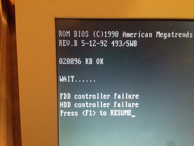

As of now however I'm receiving a continuous floppy and HDD controller failure message upon booting the system. I tried a few known good and working IDE controllers and all of them failed. What exactly did I do wrong? I reset the BIOS to prevent any issues after having swapped the battery. So, I'm confused as to what may have gone wrong.
I attached pictures of my board's chipset, all relevant BIOS setting screens and the initial error screen as well. Any possible solutions would be appreciated!

As of right now, all my controller cards are 'failing' in both my 386 and 486 machines. I don't know why, and it makes no sense. The systems boot, check RAM fine, the HDD spins up, it's heads self-test, and then the computer just hangs and proceeds to spit out "HDD Controler Failure" and "Floppy Controller Failure" regardless of what I do. I'm not sure if it has something to do with the BIOS but, I have no other controller cards to test at this point. I only have two as of right now, one Acer UN-1051, and an IDEPLUS-V4. Changing ISA slots or swapping video cards and RAM has not made a difference either.
