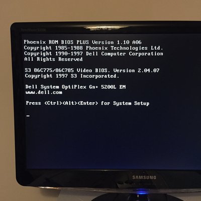

726.87 KiB
1001 views
For reference, this is the only screen that I'm getting from my Dell Optiplex.
I tried unplugging and re-seating everything, even swapping the RAM to the open slot and nothing changed.
Well, actually, I got ONE sign of life from it when I started it with all drives disconnected. It gave line item errors of "Diskette Drive Not Found," "Hard Drive 0 Not Found," and so on, but still wouldn't load system setup or anything else.
I also can't get it to boot from a diskette. The light turns on, but the drive behaves as if there is no disk present.
I have a sinking suspicion this thing is just dead.

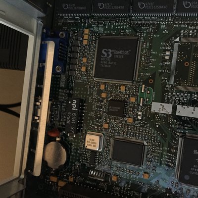

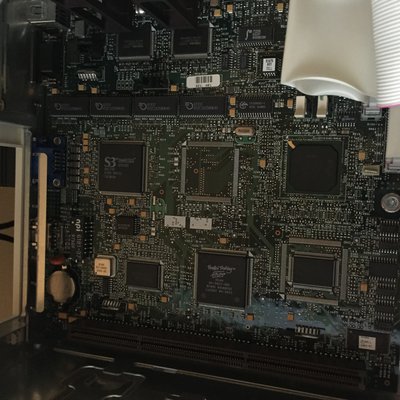

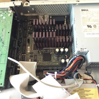

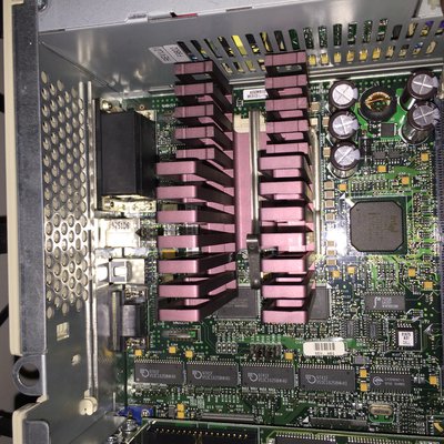

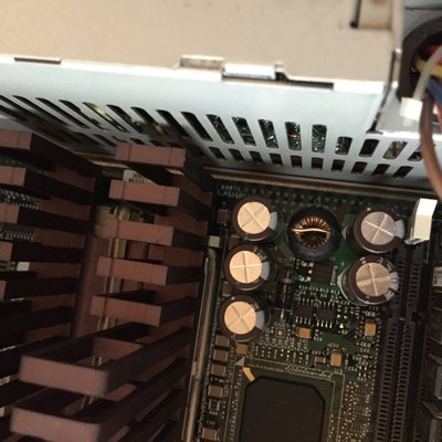

I haven't tried to re-seat the CPU, but that'll be something to attempt tomorrow when I have a few more hours of daylight to reapply thermal compound and the like.
Attached are pictures of the motherboard, both with and without the expansion card board installed. As you can see, no stains, corrosion, marks or even bulging caps on this thing.
Most perplexing is the fact that I'm not even getting a beep code from the thing. I'd try to flash the BIOS if I could get it to even boot from a diskette, but so far I've had no luck with any of it.

Reply 16 of 26, by brassicGamer
Looking at this image of your motherboard, I would put money on the BIOS being the small labelled chip just below the RAM slots:
So yes, not socketed.
EDIT: image swapped for zoomed version

Did you wait a few minutes at the point 'Entering Setup...'? At this point it's trying to talk to the harddisk and in the bad case it can take a while before it gives up.
1+1=10
Reply 18 of 26, by Runicen
brassicGamer, do you mean the "Intel" chip? Assuming it would need to be desoldered to be swapped out, right?
h-a-l-9000, I let it sit on the "Please Wait" prompt for ten minutes with no change the other day. When I re-seat the CPU, I may give it longer, but that seems like a pretty fair sign that nothing was forthcoming.
