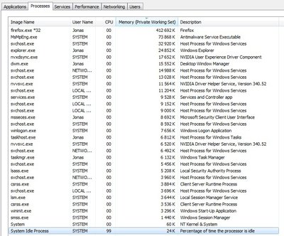

The main reason I can think of is to keep my main system free from clutter, I have single game installed on it now and only programs I actually use. I even only run the Windows services I need to run, not a single one I can manage without. Ages ago optimizing and having a clean system was important if you wanted a speedy system, it isnt important anymore but I still do it.
These are the processes I run on my main Windows 7 system with Fixefox open (with lots of tabs), I cant be bothered to play wack a mole with the Nvidia clutter.
