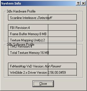

Well, the standard way to use Voodoo2/Voodoo2 SLI in WinXP is w2k 1.02.00 drivers + fxgpio/fxctl/ntremap as system services.
There is 1 small graphical bug. "System Info..." window text is misplaced:
23.75 KiB
399 views
If you replace the WinXp version of riched20.dll to WinME one - the text is ok but many WinXp programs isn't.

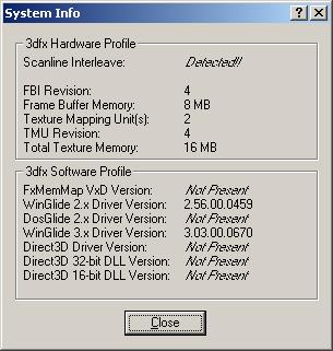

So, the easiest way to fix is to replace "52 00 49 00 43 00 48 00 45 00 44 00 32 00 30" to "52 00 49 00 43 00 48 00 45 00 44 00 32 00 31" in %system%\3dfxv2ps.dll and copy WinME riched20.dll to %system\riched21.dll. After this the text is ok:
