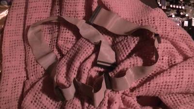

I have a 40-Pin cable that allows for four devices. I have a feeling it might be an MKE cable as used by Panasonic CD-ROM drives. MKE stands for "Matsushita Kotobuki Electronic" which is basically Panasonic and is also used to refer to their proprietary CD-ROM interface.
I will post a pic if you want to see it because it is currently hooked up to a machine I am working on and plan to take a photo of anyway. But it is pretty boring. I bought (yeah... bought) it because it was the only lead long enough to reach the top drive bays in my K&M Jupiter Full ATX cases. I used to have more of them when I ran more drives, this one was running the CD-ROM drives (IDE) until they died a few years ago. The bags were unlabeled and came from the bargain bin in a long closed computer store.
When I say bought, I mean I walked out of the door of the shop with it. I knew the manager and he would let me take minor things like that free of charge. I really miss that shop 🙁
You could always use one of the extra connectors to get an IDE LED from the cable. I think it is pin 39 and pin 40.

Here is my IDE cable, the one i mentioned earlier in the thread;
1.53 MiB
473 views
A strange cable.
That pink blanket was the only thing I had on hand that it contrasted well with in the poor light.
