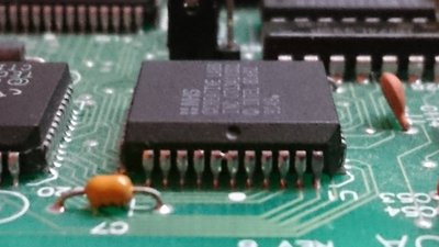

Reply 2 of 7, by j^aws
^^ Okay, so I was planning a future recapping project, then I saw this:
274.82 KiB
323 views
Is this Intel chip meant to have bridged pins like this? This chip is from a CT1330A SBPro 1. I don't have another card to check.
Reply 4 of 7, by j^aws
I removed the bridged pins by using a small file, but I'm still getting the 'Error Code: 02FF' message when testing 'TEST-SBP.EXE'. The FM plays fine but not PCM.
Could these bridged pins caused damage elsewhere? Would replacing that Intel IC fix the issue?
Reply 5 of 7, by Great Hierophant
It may be possible that they caused a short circuit that somehow damaged the chip, but in that case, it would be unlikely that your system would boot with that card if it was causing a short. Other, more subtle damage may have been done.
The only way to replace it is to find one from another SB Pro or SB Pro 2. Version may need to be identical. The Intel part is a pre-programmed microcontroller. I do not know whether it is standard or Creative-specific, but the functionality is unique to the SB Pro.

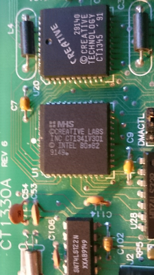

Reply 6 of 7, by h-a-l-9000
Rank DOSBox Author
DOSBox Author
If this is an 8051 then 5V and a NC pin were shorted. Now it depends if the NC pin was routed to somewhere on the board. I.e. if it was connected to ground then a trace on the board was burned. Check if 5V are available on the affected pin on the left (i.e. continuity test).

Reply 7 of 7, by j^aws
Thanks for all the suggestions guys. Here's a top-down photo of the Intel IC:
1.28 MiB
226 views
I had a quick glance at the equivalent Intel IC on a SB Pro 2 (CT1600), and it has a 'V302' instead of a 'V301' shown in the above picture.
