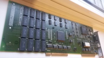

Hey!
i've got the opportunity to buy this Miro Crystal 40SV VLB, is it any good? Didn't find anything useful on the net...
thanks!
    29.79 KiB
    725 views
Reply 1 of 26, by 386_junkie
How much will it cost you? and what are the specs i.e. chipset / memory?
Reply 5 of 26, by 386_junkie
It depends on what you're looking to run it on...
Yes... it is one of the better chipsets which is best suited for Windows however it will not give great performance in Dos.
I have a similar VLB card... the Miro 32S which is also 4MB and has the S3 928 chipset... with this card it will be the inverse to your situation... good in Dos but not too great in Windows.

Reply 6 of 26, by oerk
No idea about this particular model, but I suspect it only has 2 MB. 4 MB cards for VLB are rare, and there certainly are S3 968 cards with 256kB chips.
Miro is usually high quality, so I'd say go for it.

Reply 16 of 26, by FGB
40SV means 4MB, don't worry. The more common 2MB Vision964 card is named "Miro Crystal 20SV".
