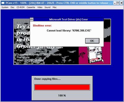

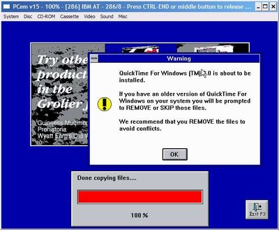

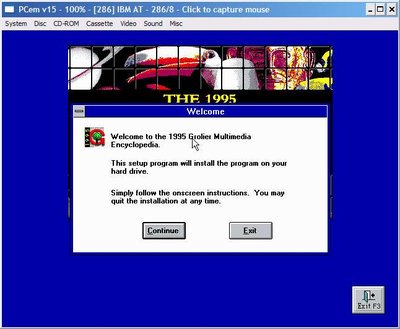

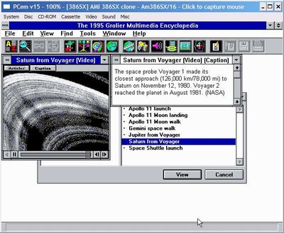

Reply 31 of 77, by Jo22
Hm. Installation of the program itself started out fine here. Until it tried to install QuickTime 2.x.
The pictures you see were taken with PCem (PC AT) and vanilla Windows 3.10.
    40.03 KiB
    1250 views
    39.64 KiB
    1250 views
    48.4 KiB
    1250 views
    42.03 KiB
    1250 views

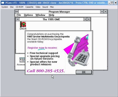

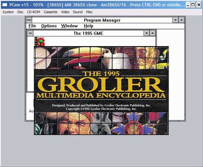

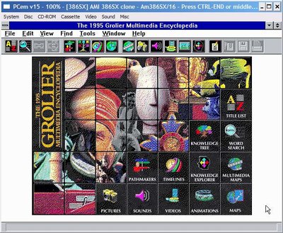

Reply 32 of 77, by Jo22
After a bit of experimention, I finally got it to work with an old version of QuickTime 1.1 for Windows.
I also changed PCem to emulation of a generic 386SX. Windows 3.10 ran in Enhanced Mode, of course.
From what I can tell, the program merely uses QuickTime for playback of movie files.
DOS and Windows were pretty much left to default settings.
    44.16 KiB
    1249 views
    77.53 KiB
    1249 views

Reply 33 of 77, by Caluser2000
The kernal386 error is an obvious clue I guess. Quicktime expects to run on a 386 0r higher by the looks.
Reply 34 of 77, by Jo22
I think the same. However, it is hard to say what really is going on.
Unless, of course, I manage find my crystal ball again and be able to gaze at the hardware and software configuration.. 😉
