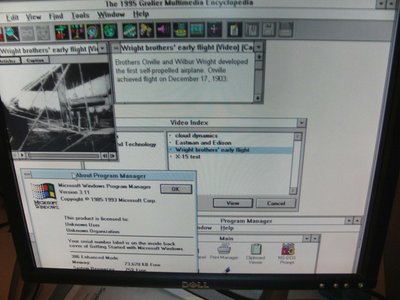

Edit: I forgot the most important! 😊 I checked the program on Windows 3.11 (non-WfW) and it worked absolutely fine.
No read-errors, this time. Not sure if that's related to the update, though.
    302.03 KiB
    1039 views

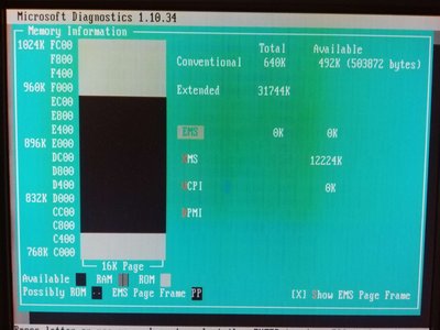

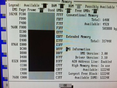

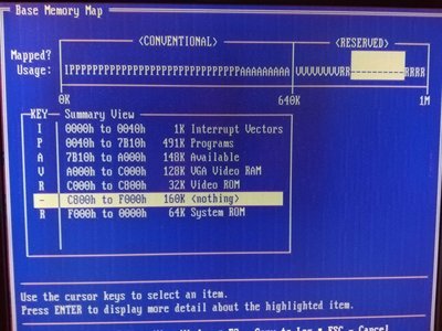

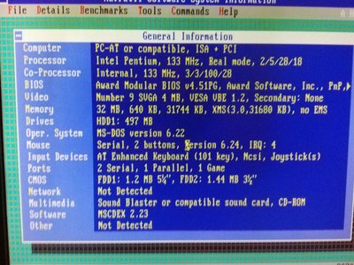

Here are the results of CheckIt!, NSSI and MSD.. 😀
The protocols/logs are also included (see attachment below the pics).
    380.94 KiB
    982 views
    536.38 KiB
    982 views
    343.01 KiB
    982 views
    217.6 KiB
    982 views
    logs.zip
    15.07 KiB
    45 downloads
