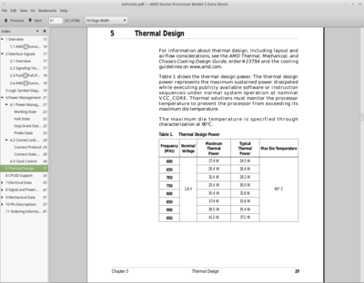

Reply 5 of 9, by pewpewpew
Spitfire datasheet
169.13 KiB
768 views
Thanks, adalbert. That's only missing AGP, which I found a maximum for over here.
