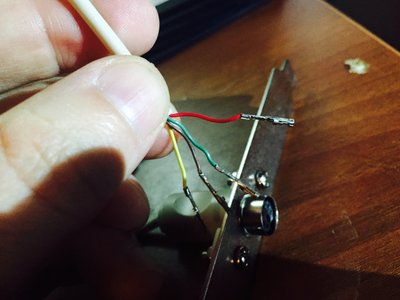

I had to use the trial and error method when I fixed the PS/2 mouse port on my Asus PVI-486SP3 board as the PS/2-port with wire and connector I found used random colored wires with a non standard pinout plug.
I tested alot of combinations when matching my 4 wires with the 4 used pins on the header. I tried to identify the wires with my MM but the probe diddent reach far enough into the PS2 port to get contact and I was too lazy to dismember a mouse cable. I was also too lazy to install a DOS mouse driver so I booted Windows 95 every time to see if it worked, I had the power on for at least a minut every unsuccessful attempt.
I diddnt manage to kill anything though so I doubt you have killed your PS/2 port even if it is possible if your really unlucky.

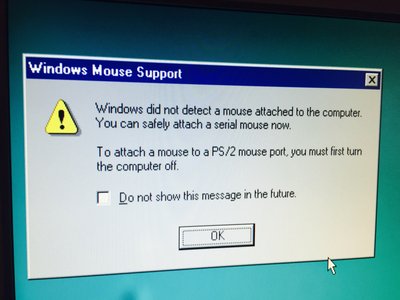

Reply 44 of 100, by chrisNova777
is it possible that its a software problem + not a hardware problem at all
im kind of thinking its both. which is why im having so much trouble
according to this video https://www.youtube.com/watch?v=Bc6HO_GPujw
the mouse i have *IS COMPATIBLE* with serial port aswell as PS/2
soooooo

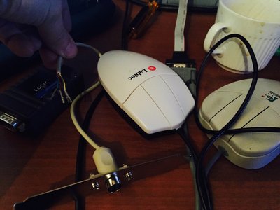

in a simultaneous alternate attempt.. i connected the labtec 3b mouse to the serial port via generic serial to ps/2 adapter
i installed cute mouse
i tried comtest with the mouse connected to the serial port via serial to ps/2 adapter and it says its a modem when its connected
and comes back with no result if its disconnected so its seeing the mouse....
i run ctmouse and it shows "cutemouse v1.9 [freedos]"
and then it says "Resident part reset to com1 03F8h/IRQ4 in mouse systems mode"
i run "win" to start windows.. but the mosue doesnt move..
please someone help me.. i just want my freaking mouse to work so i can use the damn pc
do i have to reinstall windows 3.11? to get the mouse to work? what do i have to do?
i guess my mouse is serial compatible but i dont have the exact serial adapter that came with it.. so it doesnt want to work
usign these stupid generic ps2->serial adapters that are obviously for logitech or microsoft mice

Reply 45 of 100, by chrisNova777

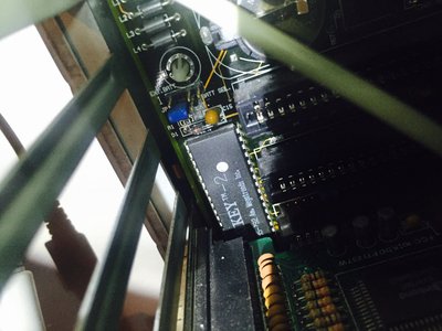

feipoa wrote:
Get yourself a $5 multimeter to determine exactly where the coloured wires are going onto the DIN. Determine exactly where the […]
Get yourself a $5 multimeter to determine exactly where the coloured wires are going onto the DIN. Determine exactly where the header pins are going to on the keyboard controller (KBC) chip. You can then determine which header pins are what (Vcc, GND, DATA, & CLK) by where they go onto the KBC.
Ensure that your KBC has PS/2 mouse support. If it is AMIKEY-2, for example, it has ps/2 mouse support.
Ensure that your specific BIOS revision has PS/2 mouse support. The power management mention of IRQ 12 means nothing in this regard. You may need to open a soft-copy of your BIOS image with MODBIN to ensure the PS/2 mouse option is checked. If you like, you can send the imgae to me and I'll open it with MODBIN.
its a revision 2.1 486SV2GX4 motherboard...

like i said before the only place it shows ps2 mouse in the bios is in the power mgmt screen for the irq 12
and i realize this is for toggling POWER MANAGEMENT.. theres no other settings anywhere..
other then the jumper for enabling ps2 mouse support on the board.. jp7.. above the first vlb slot..
which is one of three jumpers found in that location.. it is set to pins 1 +2 to enable it..
do i have to DISABLE this to use a serial mouse???
feipoa:
u asked if it had amikey2 . i uploaded apic to show the amikey2 bios chip itself..

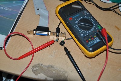

Step by step:
0. Please stop whining.
1. Buy a cheap multimeter.
http://www.ebay.com/itm/Digital-Voltmeter-Amm … gUAAOSwHnFVkYPk
It's less than 10 USD, and useful for many other things. As a result, STRONGLY RECOMMENDED!
2. With a needle and a multimeter, find out which cable is connected to which pin in your PS/2 bracket connector:
234.5 KiB
788 views
There is no PS/2 connector cable color standard, there never was. Nobody can help you about the pin layout of your specific PS/2 bracket, you need to find it out by yourself (you've already seen that, same part from startech.com can have different cable colors, right? This is what I'm talking about). Take the picture below as reference, find out the cable colors for pin 1(data), pin 3(ground), pin 4 (Vcc +5V), and pin 5 (clock)
Prepare a table like this:
 Pin              Color
Pin 1 Data Color W
Pin 3 Ground Color X
Pin 4 Vcc 5V Color Y
Pin 5 Clock Color Z
3. Optional: Buy a 2 x 4 connector.
http://www.frontx.com/pro/cpx075_10.html
4. Using the picture below as a reference, connect the wires you identified in step 2 to the appropriate pins on your motherboard. Or prepare a 2 x 4 xonnector with the same pin out, if you choose go for the optional step 3.
Connect:
Color X (ground) to pin 1
Color W (data) to pin 2
Color Y (Vcc 5V) to pin 4
Color Z (clock) to pin 5
file.php?id=20469&mode=view
YOU ARE DONE !!!
In short, people have already been helping you, please, stop whining and make use of it.

the winbond io controller is much more likely to be have a damaged serial chip.
alexanrs : u are missing the point that there have ben numerous poeple who mentioned both parts i am using.. the PLATE6F from startech + the VL/I-486SVGX4 are both referenced many many times on this site. if they were not so well known parts i would probably take the board to someone else + pay them to fix it for me.
i appreciate the group of you taking time to reply to me, but i would prefer to focus my time speaking with sincere people of good positive attitudes who have some real idea on what to focus on to fix this. i have been posting on this board since JULY and it is now NOVEMBER. just becuase id ont have a multimeter doesnt mean im not serious about getting this to work. id love to hear from anyone else who genuinely wishes to help me without being condescending...
and no multimeters are not 5$ where i live.. more like 50-60$ http://www.canadiantire.ca/en/search-results. … ue&q=multimeter
Reply 57 of 100, by psychz
But without one you can't check what goes where! If they're expensive where you live, try to order one over the net! IMHO, a multimeter, a soldering iron and a bottle of isopropyl alcohol are the go-to tools for old h/w... and when all else fails, you drink the alcohol 😵 Anyhow, you need the right tools for the right job.
Also no need to get whack-all over this... It's a hobby after all; trying to figure it all out should give you pleasure, so... patience I guess 😉
Stojke wrote:
Reply 58 of 100, by alexanrs
If you don't mind waiting: here it is, free shipping worldwide. It is an invaluable tool, which is also great for testing old PSUs (though not as good as an osciloscope - but that is on a completly different price level).
By the way, you should test the mouse on another PC, just to be sure it is working. Sometimes even brand new PCs have headers for a serial port, so it shouldn't be that hard to find a test subject. Try a simillar setup, DOS + mouse driver. Also, since you are using a controller card, double check that the onboard ports are disabled. If they can't be disabled, set the onboard ports as COM2 and 4, and the controller as COM1 and disabled (or COM1 and COM3). Anyway, ISA multi-IO controllers are as cheap as chips, so getting a spare never hurts.
About the PS/2 header, there are only three probable causes AFAIK:
1 - Wrong pinout
2 - lack of BIOS support / BIOS not configured correctly
3 - Busted motherboard or keyboard controller
Until you can be 100% sure that the pinout in your cable is 100% correct, I'd avoid trying to flash another BIOS or changing the keyboard controller - as you may make things worse. And, for all that is holy, do not flash the BIOS without making a backup of the old one first. Once you are sure the pinout is correct then you need to see if the port is delivering power. A multimeter is a quick way to do so, but any modern laser mice should do it - if it lights up it is getting power just fine. Those cheap chinese mice with transparent/semitransparent bodies are perfect for this. The next step would be testing continuity between the port and the controller, but that is one step that cannot be done without the proper tools.
Reply 59 of 100, by chinny22
chrisNova777 wrote:
i actually just got the mouse to work on com2.. but it didnt work well.. it was very slow + choppy.. something must be wrong with the UART FIFO chips?
Serial mouse is your easiest choice to get up and running as soon as possible. Give up on the PS2 port, Save that project for a later date.
Don't use a ps2 mouse with a converter, it just adds another level for something to go wrong. Get something like this:
http://www.ebay.co.uk/itm/New-2-Button-Serial … J4AAOSwTapV3bd6
There are better ones out there, cheaper ones out there, whatever you want just get one that has a simple DB9 connector.
Create a Dos boot disk, no need drivers, autoexec.bat, config.sys or anything just copy mouse.com and edit.com onto the floppy.
Boot using the floppy run mouse.com, run edit. move the mouse round is it choppy?
do the exact same thing on a 2nd PC noew or old/ anything that's got a real serial port, (no adaptors!) is it still choppy?
Windows is no good for troubleshooting, already has loads of drivers, system config settings, etc confusing the issue and getting in the way
