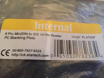

Reply 82 of 100, by chrisNova777
i still have not heard back from startech - they told me they would be in touch with the info about the pin out for the PLATE6F - i will make sure to post this info when i get it from them
for other people that have hte PLATE6F - if anyone else has already figured it out.. please share this info!!!!!

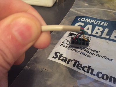

Reply 83 of 100, by chrisNova777
IK so they finally got back to me and apparently they don't have the information for the backplate pinout either but they sent me a brand-new one the second one that I might cut it up to see the pinout. Here's a picture to document the original configuration of the ten pin header
i still havent got a multimeter + i still have no idea which wire color is which
is there a standard 10pin ps/2 header configuration i can look up somehow that correlates to this config?
does anyone else remember seeing any documentation about a 10pin IDC connector ?
i mean these plate6f devices must have been made specifically for some purpose?
i wonder which motherboard maker? perhaps its not even pc? because im checking asus manuals for
boards and i cant find any that use this config

Reply 84 of 100, by Malvineous
There was no standard for this kind of connector so it's anyone's guess. You might be lucky and they did it properly, with pin 1 going to pin 1, pin 2 to pin 2, etc. But the only way to know for sure (without destroying the cable) is to use a multimeter. You can get them from China for $5 or less and once you have it, it'll take you maybe two minutes to figure out the pinout, so that's by far the quickest option. If you have a hackerspace near you, you could also ask them if they can help - most will probably oblige because it's only a couple of minutes' effort and they already have plenty of multimeters.
Reply 85 of 100, by alexanrs
Just a thought: Is the other side of the cable (the one with the PS2 jack) covered by hot glue? If that is so, just peel it off and see which cable goes to what pin

Reply 88 of 100, by chrisNova777
its sealed i would have to cut thru the plastic to see

Reply 94 of 100, by Stiletto
Hah, I helped sell Startech products as a reseller back in the day, and they never had what I would call decent reliable info on any of their products - maybe the big ticket items but not little twitchy adapters such as these.
I think this is an incorrect assumption.
If I had to guess, I'd guess that the block is not wired to any standard (indeed there is no PS/2 header standard) and they provided the wires in the block for organizational purposes, so as not to sell something with bare dangling wires - knowing that most purchasers would be getting out their voltmeters or multimeters to determine how it should be wired up and rearranging the block. They'd bag whatever they had available provided it met the general description (PS/2, 6 pin, Female) hence why Artex's and yours were the same part number from the same mfg. but wired differently. So they likely used 5x2 just because that's what they had on hand that could hold all the pins (and they were making those in the era of USB headers, so this makes sense to me! 😀 )

Reply 97 of 100, by feipoa
I do not think many people will benefit from your findings because not all PS/2 cables are colour coded the same. Anyone who buys or finds a PS/2 breakout cable with header will still need to use a multi-meter to find where the pins are going. I have about a dozen PS/2 cables, all with different pinouts on the header and colours of wires. There was no standard. Startech will also likely sell cables with different pinouts in the future, depending on what their supplier sends them.
Reply 98 of 100, by Stiletto
Exactly. chrisNova777 could work out the *exact* pinouts for his Startech PLATE6F but so long as they keep selling them, they will be wired differently from each other. I bet in 100 PLATE6F's you buy online, since resellers these days are pulling from new-old stock, you'd get at least three different wiring schemes to the header block, maybe more.
