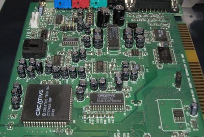

Has anyone else here got a CT4500 which they could reference these two parts?? (see image)
This image was taken from Google, this section is somewhat burnt on mine. I need to figure out the regulator and the resistor just in case I wind up with this board and try to save it with a repair.

I've got one right in front of me. The regulator is an ST MAL 9722 78M05. Also, C95 is not a resistor, but a surface mount capacitor. The "C" in C95 indicates it is a capacitor. I will see if I can get you some close-up shots of the card tomorrow.

The 78M05 is a standard 5V linear regulator. You just need one in DPAK format from any of the usual suspects. I'm guessing Creative didn't stray too far from the reference circuits. The Fairchild datasheet specifies 300pF on the input (C95) and 100pF on the output (C96). You could even bodge in a through hole cap as a replacement.
My only concern would be if anything else was torched by whatever blew the ass out of that reg.

@gdjacobs: Boom! that is exactly what I needed.. I'll tie 5v/Gnd into the output side from one of my USB microcontroller circuits off my workbench and see if the card even starts making reasonable sounds. I'm getting clicks/pops right now, so there *might* be hope.

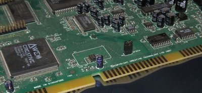

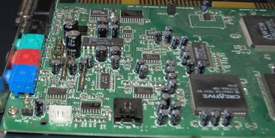

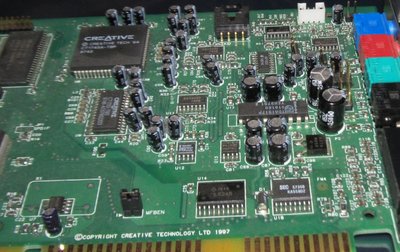

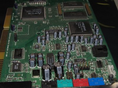

I found that I had a CT4500 stored.
I measured C95 in circuit, and across those points the capacitance was 183uF both directions. That's probably not very helpful because obviously that much capacitance isn't coming from that 1 little ceramic cap.
From appearance, it looks the same as C96, C80, C81, and C78 which are scattered nearby. It is smaller than the size used at C94 and C79.
C10 and C35 are both the same. On my card they are 10uF 16v 85C rated.
I took pictures of the card from a few directions. They try to show the area where you said your card is burned, but it may still be hard to see the details. The angles are too shallow because of the tripod, and my lighting isn't good either.
I'm being told there's a limit of 5 picture attachments. I'll post the last pic in the next post, which shows the markings for capacitor C10.
