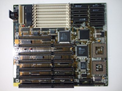

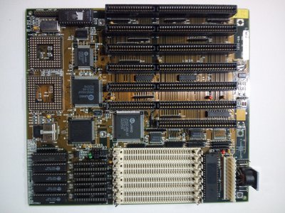

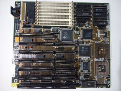

Here are 5 out of the 7 (thought to be 8 ) boards that I have. I'll post the other down below wince I'm maxed at 5 attachments.

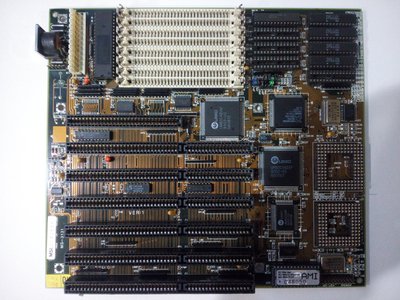

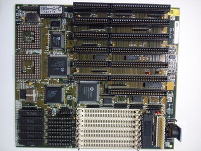

Here are the other 2.

Thank you. I couldn't help but notice that the cache installed on these boards is all over the place.
All of these boards are identical, with the exception of the chipset production dates.
Reply 38 of 43, by x_86
Yes, all cache chips are -20's, so from what I understand that allows my am386 to run at 40MHz. Luckily I have enough to make a full set. Also, the only thing not shown in the photo's are the serial number tags located on the side of the last ISA slot.
