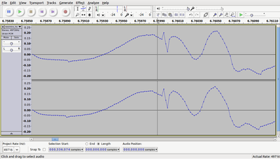

Reply 14 of 16, by Jepael
The DigiSnap is easy to modify for OPL3 (well, at least YMF262) capture, just use the leftover NAND gate to invert the bit clock from YMF262. It will still be compatible with OPL2 (YM3812), because data is stable on both bit clock edges. Of course the software needs to be modified for OPL3 to store the raw capture instead of emulating the DAC analog shifter. Still, it's not stereo and needs a capturing PC old enough to have EPP parallel port, but it'll work.
Here's a screenshot of a real YMF262 (OPL3) playing neointro.hsc, a direct digital capture of serial audio bus via USB, decoded to signed PCM values and imported into audio editor. Those spikes are quite visible, as well as audible. The music is mono but as both left and right OPL3 channels play the same sound in OPL2 mode, this is not a simple one-off bit-glitch during capture or other error as it is far too deterministic, they really are the actual left and right channel samples.
I bet I have some Monkey Island captures somewhere, but I could not find them. IIRC, they have similar clicks, and Indy should have approximately similar sound driver anyway.
    61.32 KiB
    1004 views
    YMF262 serial audio bus capture of neointro.hsc
Reply 15 of 16, by DjLc
Thanks for your reply. After many test with different hardware, my conclusion was that the driver used by game was involved. This explain why with others games i didn't have thoses spikes or a least more less.
For curiousity, how did you do that ? Custom build ?
Thanks.
Reply 16 of 16, by Jepael
I'd blame both the chip for having the property sudden phase reset on note start, and the driver, instruments and music itself for not hiding this property.
