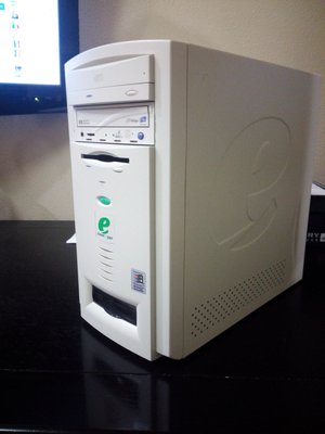

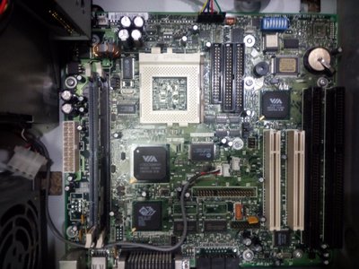

So here are some pictures, and the model is a etower 300k. The board is a DELHI-II 586-0429, on-board ATI rage video card, 256mb ram max, 2 pci, 2 isa,
and the Socket 7. So I have already looked at spec sheets and can't seem to determine for certain if this is a Super Socket 7, and if it supports the "+" series K
processors. I know it will support all K6-2 and k6-3 processors. I want to jump on a processor, that is, or if not similar to the AMD-K6-2/550, which from what
I see is a very good processor, if you clock it down to 500MHz so it remains stable. So, what do you guys think? Maybe some SLI video cards going on ^__^?

In a quick look I did not find a DELHI-II.
Are you sure it's not a DELHI-III ?
What are the exact model numbers on the VIA chipset chips?
The DELHI-III manual states it supports a 2.0v Vcore and 100MHz FSB.
If there is a DELHI-II it may not.
Reply 4 of 19, by idspispopd
I suppose that should say DELHI-III?
According to http://www.interloper.com/products/product-de … =106987&cat=399 is has a VIA MVP3 chipset and 100MHz FSB support so I'd say SS7. It should work with all K6-2, also K6-3 (if the voltage regulators are OK). No idea about the + models. Are there any settings silkscreened regarding voltage?
Reply 5 of 19, by x_86
it does say DELHI-III, and that looks like the board from the picture. Judging by this https://en.wikipedia.org/wiki/Super_Socket_7 , if you read the first paragraph this indeed should be a Super Socket 7, in which supports up to 2.4v. Still, nothing about the "+" versions. I also don't see anything printed on the board about voltage settings. There are a few jumpers around the main socket though.

I have the manual for the DELHI-III.
It specifies the max K6-2 as 350MHz but the board may have been released before the faster K6-2's were available.
A newer than original BIOS may be needed to support faster K6-2's but other than that it should work.

Thank you very much for the document and your input. If you look on page 9, you will see some text about all the different voltages that are supported and that they can be adjusted. So I suspect that you're correct and I can most likely do the processors I'm interested in with some tweaking. Also, how do you feel about the RAM options for this motherboard. Would it be worth going with ECC over non-ECC, because the board does support both.

Regarding the voltage: The manual indeed says you can go down to 2.0V, but only specifies the settings down to 2.2V. Comparing the datasheet for SC1152 to the manual I'd say 2.0V should be off-off-off-off and 2.1V should be on-off-off-off.
I suppose you won't have BIOS support for the + CPUs but you should be able to work around that with some tools.

If it has undocumented jumper settings, it should be fairly easy to figure out which ones are the other voltages (supplied to the CPU).
Many SS7 boards have jumpers for the CPU voltage which behave like this:
The CPU starts with 3.3v
Jumper 1 subtracts 0.8v
Jumper 2 subtracts 0.4v
Jumper 3 subtracts 0.2v
Jumper 4 subtracts 0.1v
It's basically a little math puzzle, but I don't have Word installed so if I open it, it's just all gibberish. If anyone would be friendly enough to post all of the known jumper settings along with the given CPU voltages, I can figure out the rest of the puzzle if nobody else feels like bothering 😀
My retro rigs (old topic)
Report spammers here!
Reply 18 of 19, by Skyscraper
In my experience some boards behave almost like the example above but with 3.5V as the max voltage.
Minimum voltage with the table above is 1.8V but some boards only go down to 2V but the jumpers behave more or less the same.
No jumpers = 2.0V
Jumper 1 (or 4 on some boards) adds 0.1V
Jumper 2 (or 3 on some boards) adds 0.2V
Jumper 3 (or 2 on some boards) adds 0.4V
Jumper 4 (or 1 on some boards) adds 0.8V
In this case the max voltage is 3.5V.
